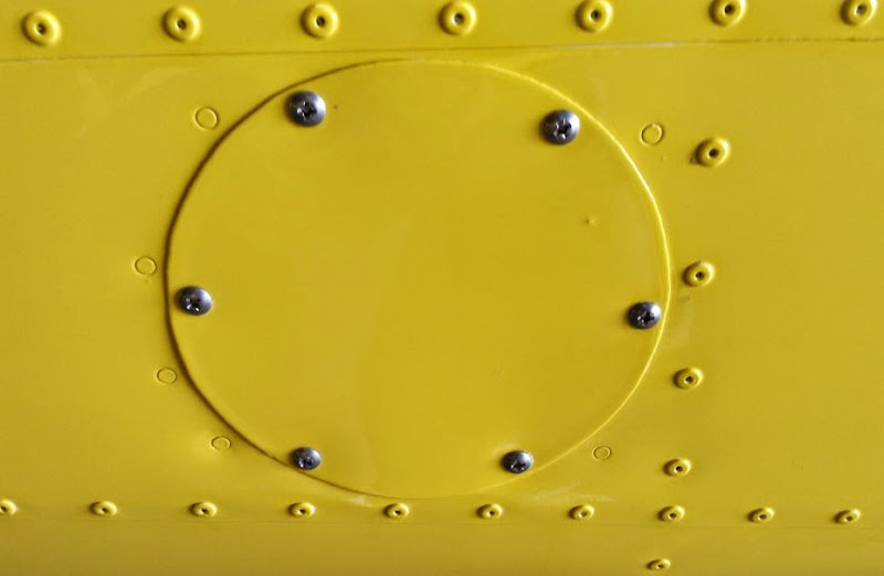

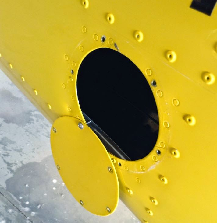

Instead of modifying the bulkhead I cut three 4" diameter inspection holes on the belly and one on the left side at the tail. This gives all the access I need for routine inspection and stabilator removal. I riveted doublers behind each opening and used 6 nut plates for each cover. I also put ports under each control stick for a total of 6 ports.
It's also easier for this old guy to look through the ports than it would be to climb into the baggage compartment.

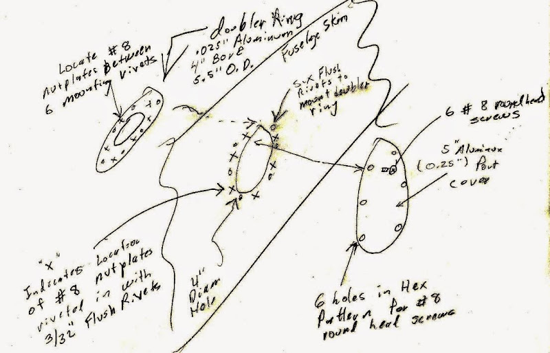

I installed a total of 6 ports:
1 - Right side near the tail to facilitate stabilator counter balance arm access.
1 - Just aft of the aileron auto pilot servo for inspections.
2 - Just forward and aft of the elevator cable wear block for replacement access.
2 - one under each control stick to access control linkage for adjustment.
I copied the design on my Cherokee. Each is a 4" diameter hole. I cut a 5.5" ring with a 4" hole to act as a doubler. I riveted the doubler in with 6 flush rivets and then riveted 6 nut plates in the gaps between the 6 rivets. The covers are 5" diameter disks.
You can get the doublers in in bending them so they can go through the 4" hole, just flex them a little so they don't crease.
Send me your email address and I'll send some pics.

Great! Be careful with the port for the counter balance arm, or you may get too close to the hooked edge if the fuselage skins. I dodged that bullet more by luck than design.
Here are the pics provided by RFS.
