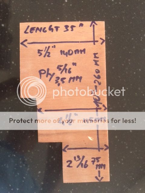

I have pics of Keith's bagage box, together with measures.
It seems to be impossible to attach pictures to this thread, but if you want the dimensions just send me a pm hans [dot] labruyere [at] gmail.com
Keep in mind that the bulkheads are INSIDE the skins - otherwise you'll be 5/16" short...

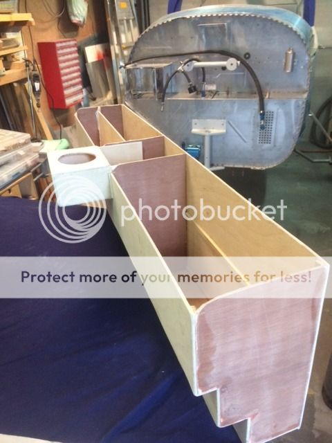

photo's at last
..I took the trip down to TinyPic. Dunno if I'm happy with it, but as long they show I hope you guys are ;-)
Keep the flying!
[edit] Now find a way to turn them. For now you'll have to put your PC on it's side, I'm afraid..

Not sure what I'm looking at...how does this fit into the baggage area? The fuel tank probably won't like it😎
