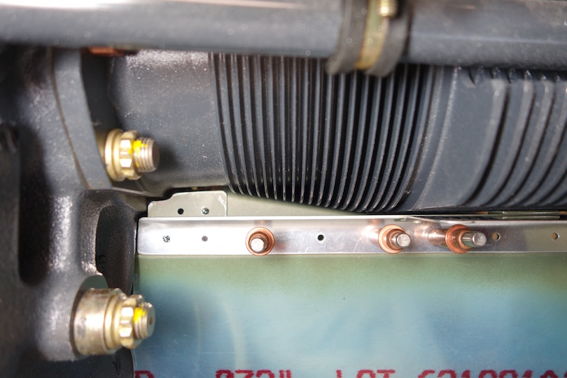

I have a Titan IOX-370 and I'm working on the Van's baffle kit for a Lycoming IO-360. The stock baffle has two sections that wrap around the side and bottom of a cylinder: a larger radius that wraps the cylinder head and a smaller radius that wraps around the cylinder barrel. The Van's baffle kit is designed for a cylinder that has equal length cooling fins on the barrel, like Lycoming and most other cylinders.
Because Titan tapers the cylinder barrel fins to save weight, the baffle touches the outboard end of the barrel but has a 3/8" gap on the inboard side (next to the crankcase). That gap between the fins and the baffle seems like an easy exit for lazy air to escape without doing the cooling work I need.
Before I reinvent the wheel, I thought I'd check to see what other Titan builders have done. Did you leave the gap, put an additional piece of aluminum inside the stock barrel baffle to form a cone, bend the barrel baffle to close the gap, cut it off and make a new one, etc.?

Not so much efficiency as closing a number of large holes in your sealed high pressure box.

I swapped from 360 to 370, considered remaking tapered baffles but thought I would try it first by just pulling the inner baffles in as far as possible and filling the gap on top. CHT's are great, no prob even on the hottest days in TX.
Closing the gap on the entry around the lower cylinder would throttle flow in that location down to pretty much the same as a closely fitted wrap. The cylinder base isn't very hot, so any loss of heat transfer there is not so critical. The key is no pressure loss at the head fins where the serious cooling takes place.

Just to add to the above, I did add some holes in the 'tangs' where you tie the baffles together (I use safety wire) on the very IB side , that helps to pull the IB end of the baffle in a bit closer to the cyl.
The upsides to doing it this way is primarily it's easy, I always prefer easy over hard.
Another is if you ever have to install a non tapered cyl for some reason the baffle still fits.

Came across this thread while working on my baffles and so far the template and the #1, #2 and #4 baffle mods fit very well. My challenge is the compound bend on the #3 baffle mod. Is there a known trick/technique to making this bend? It’s the one where the upper part of the tapered baffle flange goes toward the cylinder and then another bend goes away. Any advice would be greatly appreciated.
I don't have a secret or technique. I made it slightly oversized at the top/formed area and iterated it down to a good fit. The important part IMO is the curved portion so that there's a good longitudinal fit where the fin height steps up. I formed the compound bend with a hand seamer, IIRC. Bottom one first then match marked the baffle intersection. Sorry, no real advice. Go ahead and cut two. That way it will assure you won't need to back-up.
