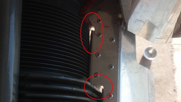

Here's part of what the plans specify, from when I placed the baffles:
Left aft baffle.
Forward baffle.
Here you can see various nooks and crannies sealed (from when I installed the control cables). Note the forward area along the forward of the crankcase, the areas around the blast tubes, prop cable and other little areas.
Here you can see the rear of the crank case sealed as well as some areas along the rubber seals (from when I riveted the upper forward fuselage skin).
They are hard to see and access, but . .

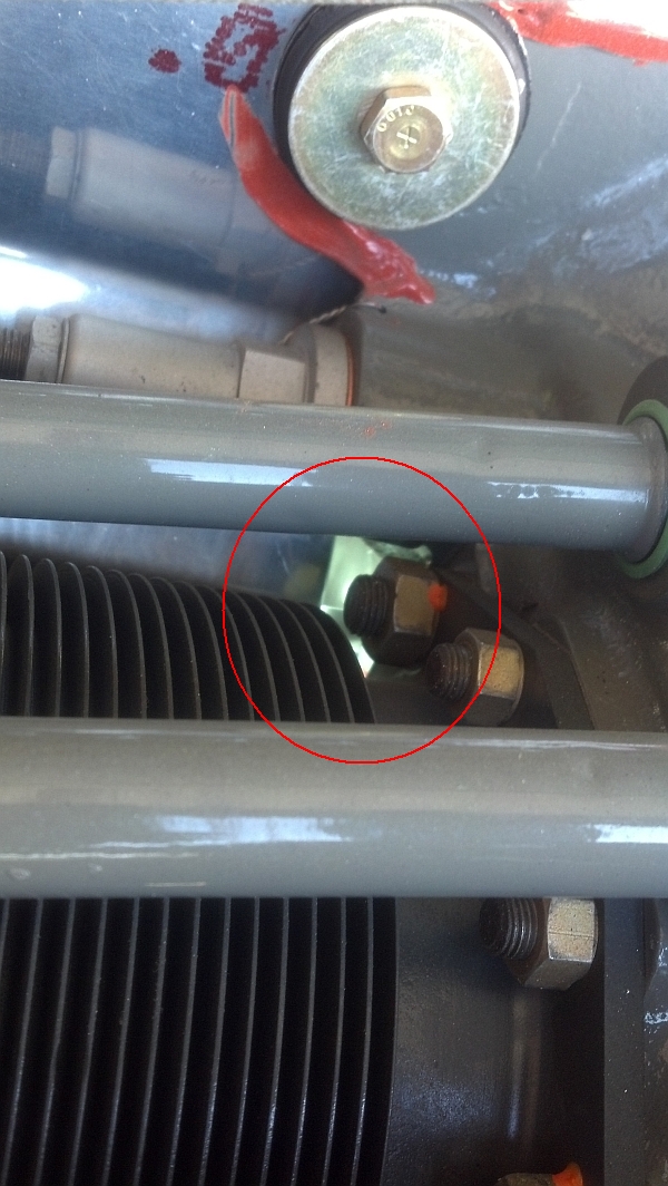

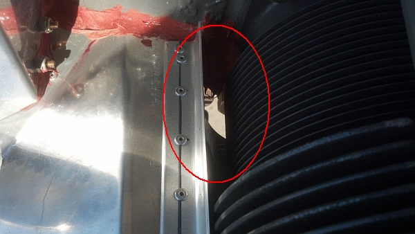

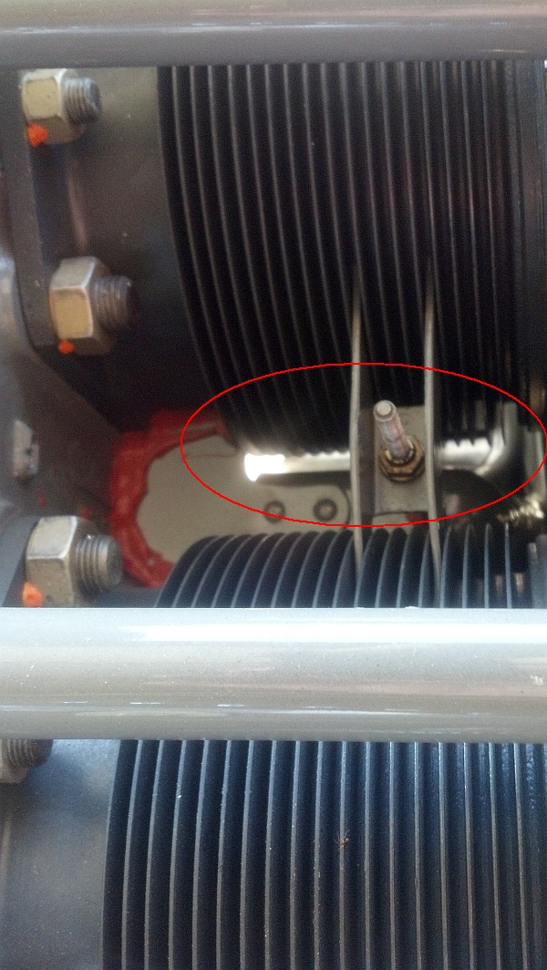

Don't forget to look closely at the intersection baffles between the lower cylinders. They were a huge leakage area for my factory M1B.

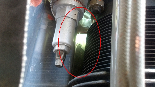

Edit: and . . did you check for the flashing on the through fins around the spark plugs?

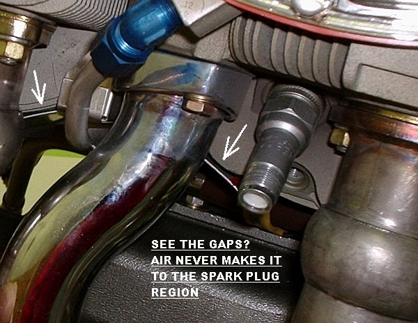

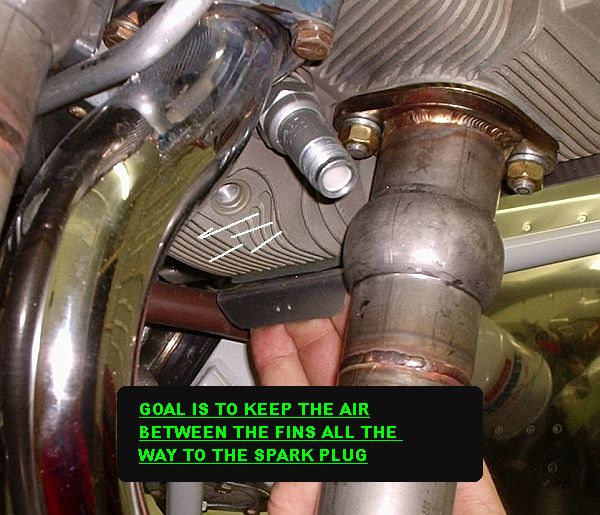

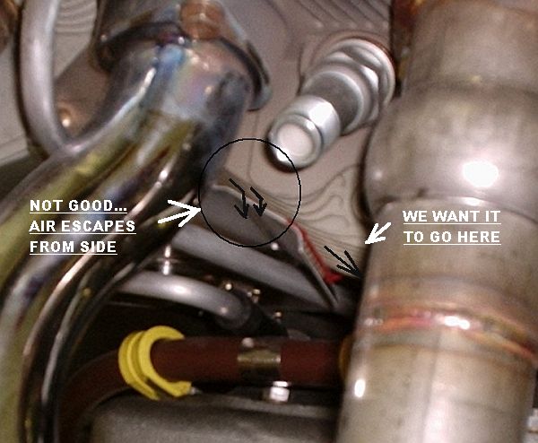

It's not hard to understand what you want to accomplish, which is to make sure every molecule of cooling air (1) remains in close contact to hot parts, and (2) actually gets to the hot places.
A light bulb held under the engine will highlight gaps.
The problem with wraps is usually air leaking from the sides, which means it does not cool the area around the lower spark plug. There are a whole lot of fins down there, but they won't do you any good if the air gets sidetracked.

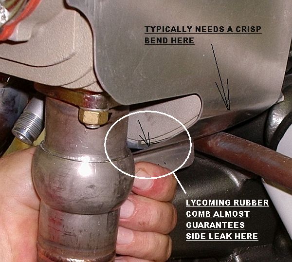

BTW, Lycoming places a rubber comb between the fins, which blocks some flow and often worsens the wrap fit problem.
Along the same lines, engine shops often add a bead of silicone across the baffle in an attempt to stave off chafing wear. However, if the silicone is up between the fins, it blocks flow.

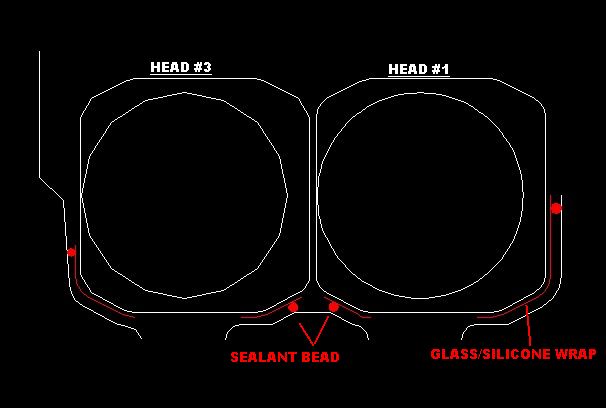

The above RTV strips seem counterintuative to me. In my head the RTV that is not touching the front of the fin would bulge inside the empty space between the fins. limiting the airflow.
Not only is there one "strip" of RTV, there are 2.
Van's instructions tell the builder to do that now?
If the instructions are followed, the RTV stripes will only be about .030 thick.
Enough to help prevent fretting wear, but not enough to cause any air blockage or leakage.
I dunno 'ole buddy. If the stripes space the wraps away from the fins by .030", there's a .030" wide leak gap along the side edges.
If the goal is to stop fretting and keep all the air where it belongs, gasket the whole inner surface of the wraps.
It is a very small amount of surface area coated with a very flexible/compressible material.
My experience is that with the wraps pulled tight it has no influence but I imagine an even coating as in your photo would be the optimal plan.
Especially if you are measuring gaps with a feeler gauge ;)

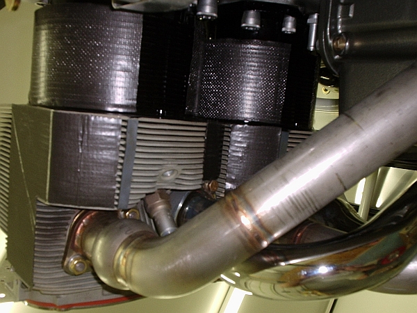

Yep, Loctite 598 or Permatex Ultra Black, same product. Roll it into the cloth between two sheets of 4 mil plastic. Cut the exact shape you wish to apply. Peel one side, stick it to the fins. Allow to cure, and only then peel the plastic off the outside.
When fastening the aluminum wraps into place for the final time, be sure to run a small bead of sealant across the the top , so air cannot flow between the aluminum and the outside of the fiberglass/silicone gasket. That would be a really useless leak.

That's a fair point, and I'm not gonna bore everyone with a homily about "better". The factory crew has the unenviable task of developing methods and instructions for everyone, which includes the least capable builders. Then they get to explain it repeatedly on the help line. The prescribed stripes (to prevent wear, not seal) are simple, and if they can get the builders to actually fit the baffles tightly, it's good enough. Airplanes shall fly. Grins will be seen.
As for us nut cases, zero leakage is the goal. It's a mental illness with a justification ;)
BTW, it's important to differentiate between merely gasketing the standard cylinder wraps, and extending the glued-on gaskets further up and around the cylinders and heads. The first is just improved sealing. The second has a bunch of interesting effects, some of which, depending on application, are quite experimental.
Regardless of which path is taken, please, take the time to fit the baffles, not just drape them on the engine.
