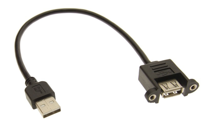

I noticed that the supplied usb would work, then sometimes not. If you look on the back of the skyview, there are 2 other USB ports. I got a 3 foot extension cable, and ran it from the back of skyview into the map box. No more issues. I drilled a hole large enough in the map box and installed a rubber snap bushing for the usb cable. Simple.
I put a USB port in the panel just above the screen. Bought a 9" USB lead on eBay and plugged it directly into the back of the Skyview. Cheap and works well. I recall others saying that the standard port mounted under the panel seemed to be a bit temperamental. Mine's installed, but I've never used it.
I had the same experience (intermittence of the panel connector - even got a replacement one from Stein) and did the same extension cable solution. I routed the cable into the glove box. I leave a USB stick in it all the time and at the end of each flight I download the logs.

I installed two short usb panel mount cables (cheap on eBay);

If you buy a extra usb port ext. , make sure its a USB 2. I tried the USB3 cable and it did not work. The USB2 cable did.
