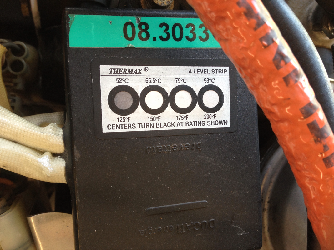

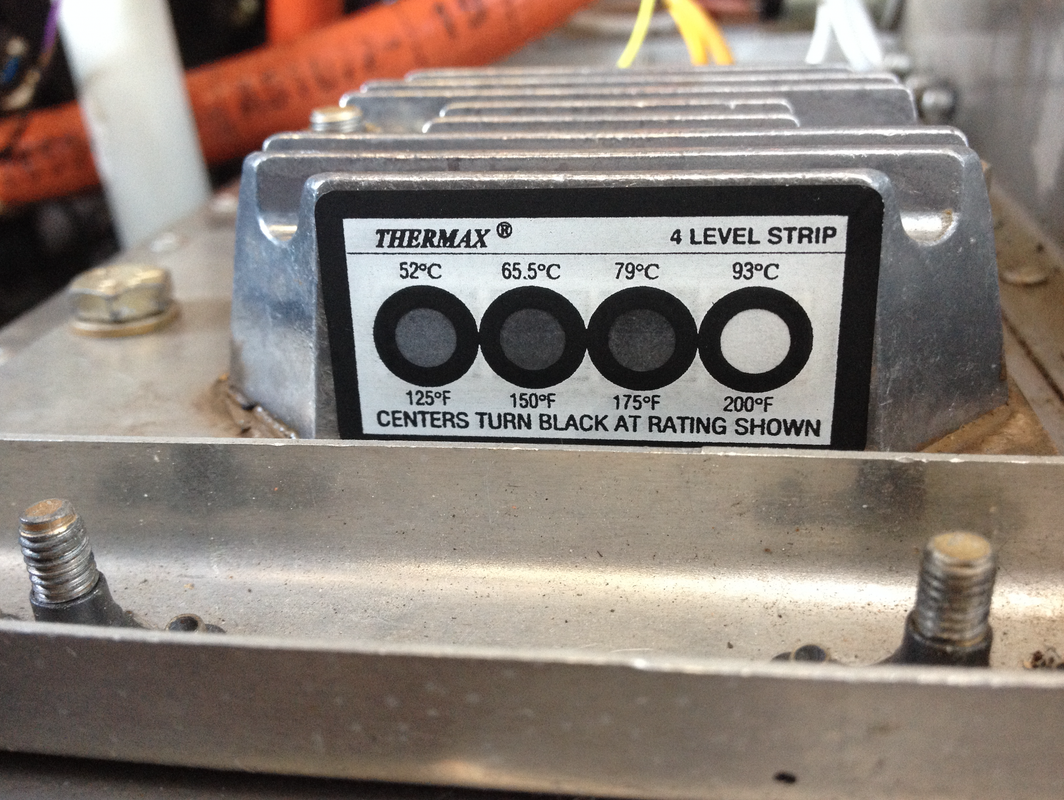

I had one of the two ignition switches fail internally at @ 500 hours -- it was an intermittent failure. Replaced the failed switch with new and all is well.
Alternatively, there is much discussion on the Rotax Owner site on using an ice bag or heat to troubleshoot older-style ignition modules.
The ignition coils and CDI units are mounted on top of the engine which is tightly cowled on the RV-12. I open the oil access door when the airplane is parked to let the heat percolate out.
On a similar occasion, I found that the shielded cable going to the cdI units where the cable shelding was bared and clamped to ground was loose and had worn through the insulation of the internal wires and also grounded them, causing the failed B circuit. A quick wire replacement got me going again.
I had a 912 on a different aircraft that lost one ignition and it turned out to be a broken wire going to the CDI boxes. It was broken inside the insulation from vibration/movement and I only found it by pulling on the individual wires going to the connector. The wire would “stretch” because the actual wire was broken and the insulation was stretching. Repaired that wire & it was running great when I sold it. Long shot I know,just a FYI.
