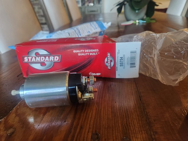

After being stranded a couple times by the dreaded Skytec click, my A&P and I tried to install a B&C starter in my RV-14A. Couldn't get it to fit.
I did note the Skytec would turn again after cooling a few hours, so evidently our issue was heat/solenoid related.
We found a longer-term solution was to replace Skytec's solenoid with a stock automotive unit from NAPA and it's worked fine ever since.
Do you have a part number for that NAPA solenoid?

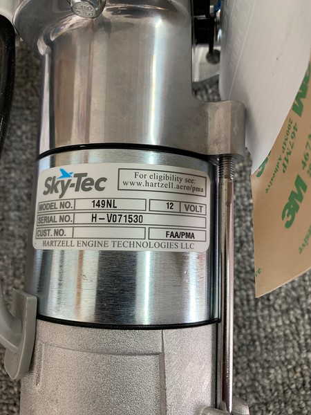

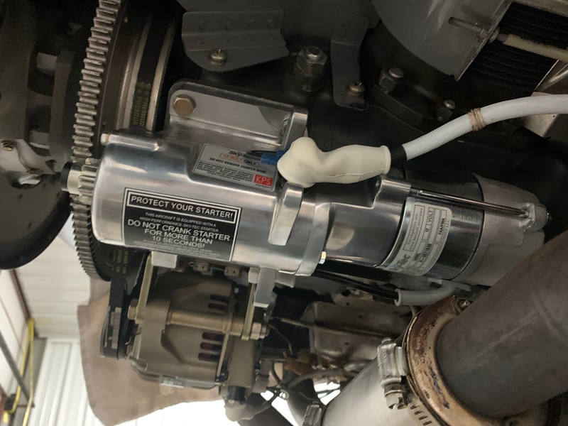

update 149NL fit
Hello all,
just an update. Skytec sent me a 149NL to try in regards to fitment. I was pleasantly surprised, it fit. I had to alter the mixture control linkage a little but was not a big deal. Now just have to either do a little fiberglass work or remove a lug on the starter.
Hello all,
Good news, you will be happy with the NL. I ground off the lug.

As with Rob, I have the NL and it works great. Grinding the lug is approved by Skytec and doesn't affect the warranty. My LS solenoid went bad like most everyone else.
I ground off the lug as well. Thanks to all that replied with help and thanks to Rob for the pictures he emailed.

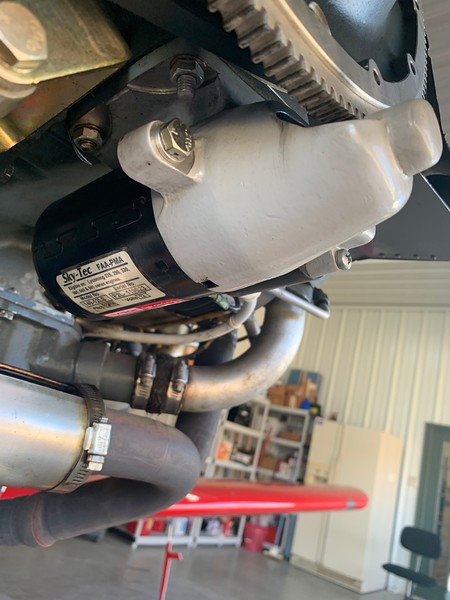

I replaced my flyweight Skytec (standard equipment on new engines from Van's) with their 149NL back in November 2021 on my O-360-A1A. It is much heavier than the original lightweight starter but fits perfectly and cranks well. The old flyweight starter began to cause the prop to violently flay back and forth on start -- the action was so severe that it gouged my cowling. Visual inspection showed nothing amiss with the starter, but after the second time it happened, I pulled it.

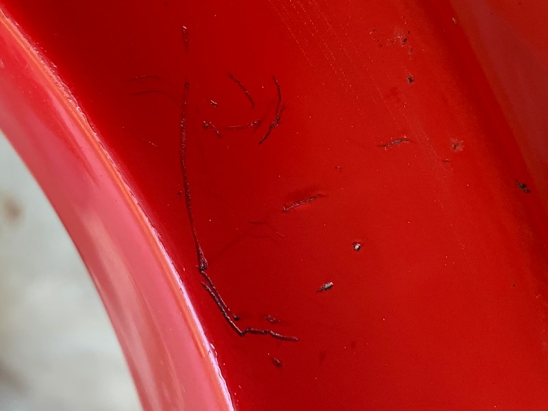

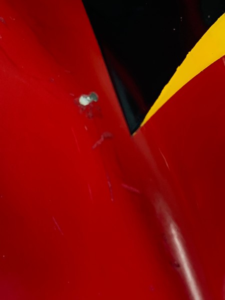

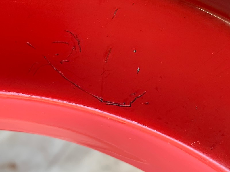

Original Skytec Flyweight starter installed O-360-A1A
Example of gouges in cowling behind spinner caused by starter malfunction
New Skytec 149NL
New starter fits fine but is much deeper (length) and heavier than original starter

Say what?!...
I'm trying to get my head around ^^ ^^ this description, the pictures showing the "gouges"...
it sounds like you are describing kick back, which, to be sure, is a bad thing. The gouges are most likely caused by broken/missing teeth -- did you count 149 teeth after the event?
Brian:
You're right, kick back is how I described the experience to the locals here. It was quite violent and I had never experienced it before. On my second try at starting the engine engaged fine and I flew home. I asked a local A&P to look at it and he said visually it looked fine (all the teeth were there) but he noted that he had seen many failures of these units citing cracks in the case, a short in the wiring, etc. He added that it is often difficult to determine the real cause of the failure.
I flew the aircraft twice after that and the starter worked fine. On the third flight however, the same thing occurred. Again, very violent as the prop kicked back and forth over a very narrow range when I pressed the starter button. No one I spoke to about it had ever experienced such an action but I couldn't afford to let it happen again and with so few possibilities as to the cause I concluded it had to be the starter. So out with the old, and in with the new.
So far, the new starter works great and I haven't had a repeat of the kick back. There were a number of other areas with similar gouges on the cowl surface that faces the back of the spinner plate. (Note, the gouges are on the exterior of the cowl, whereas the starter gear teeth are on the inside. So I'm assuming there was contact between the cowling surface that surrounds the prop hub and the back of the spinner. I still can't imagine how the cowl would move that much to make contact but the gouges are very real. )

https://www.napaonline.com/en/p/ECHST421?impressionRank=1
It's commonly used in the 2005 Ford Crown Victoria.

Starter Malfunction

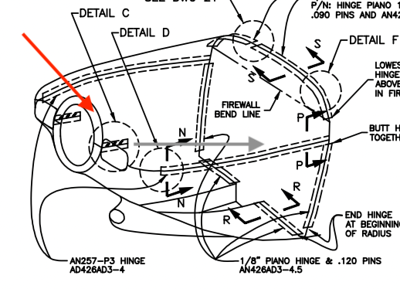

I too am curious about the gouges in the cowling. What made contact with what ? Maybe another picture from farther away on the cowling to get some perspective.
I'm not near the airport at the moment but perhaps this will help. The image below is from Plans Drawing 48. The red arrow points to the area where the gouges occurred (disregard the gray arrow; it's an artifact from my poor editing). The gouges are on the flat circular area of the cowl that sits directly across from the spinner backplate and spinner. I included a couple of other photos for reference but they are all closeups so probably doesn't help with the orientation. I'm guessing that the shaking caused the cowl to flex and bump the spinner. Of course I had just touched up paint on the cowling in other areas. Guess I'll be doing that again. :mad:
Drawing 48 – note red arrow pointing to area of gouges. Flat face that is opposite the spinner and backing plate.
Another view of some gouging
And another view of some penetration of the paint
