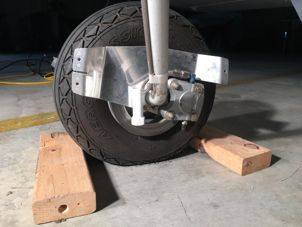

You might consider something like this:
Sandwich the lower portion of the gear leg between two padded blocks of wood using a big C-clamp. Lift with a suitable jack.
What I made today was two pieces of angle iron that clamp onto gear leg, I then fit another piece on the inboard side to create a flat to accommidate a bottle jack, I welded the pad adapter to the angle iron, works great, thanks for the photos and suggestions to all.

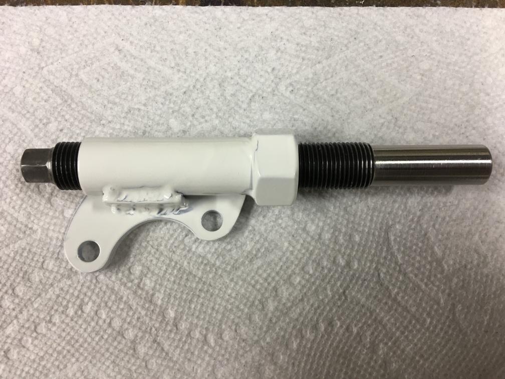

I was looking for a light weight method to elevate the axle should I have to fix a flat tire in some remote location, something that would fit in the aircraft tool bag along with a bicycle pump / spare tube and not pay a huge weight penalty. After a few sketches, this was the result.
The screw is 6" long 5/8-16 threaded rod with a 7/16? hex machined on the end for a socket wrench. The OD of my 7/16? socket is just under .625 so it will pass into the tube allowing additional lifting height.
The total weight of the two axle assemblies and screw is less than 1 pound. Not shown is a small swivel pad that is placed on the end of the screw to prevent walking. (Similar to what's used on a a C clamp).

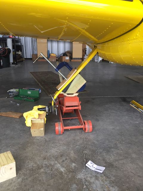

Axle Jack
This is not an original idea, I got it from another RV-12 owner. It consists of a piece of a 4 X 4, cut to an angle so the bottom is parallel to the floor. You then glue rubber or foam to the side that will be next to the landing gear. Then you use a piece of 3/4 plywood or a 1 by 4 would work, and glue rubber or foam on one side of it. The rubber or foam is to protect the paint. Then you put the 4 X 4 on the underside of the gear, the plywood or 1 by on the top side, and use a large C clamp to hold them together. The put a floor jack or other jack under the bottom and jack it up. That is what I use and it works well.

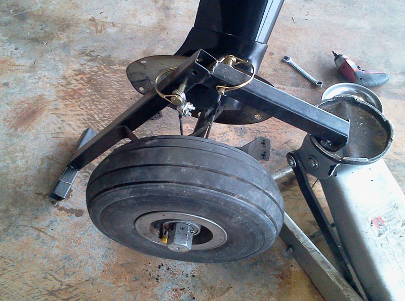

I used a couple pieces of angle iron that I bolt to gear leg, then used a bottle jack, you can use rubber from an old inner tube so you don't hurt the paint, works great. If I knew how to post pics I'd share my device but its pretty simple to make.
