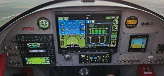

Those of us who have pulled the trigger and purchased Garmin's latest and greatest might want to share their experiences with the AXIS system here. Many years ago, my father taught me how to fly in a J-3 Cub, an Aeronca Champ, and a Luscombe. Those panels weren't anything like what many of us fly behind these days, and some of the best learning experiences I've had in my transition to the all-glass cockpit have come from other pilots who openly share what they've learned. I'm very excited about the AXIS system, and from what I've already seen of it, there will be many, many hours of enjoyable flying to come with a fresh installation in my newly overhauled RV-8.
My installation comes on the heels of a newly installed G3X system. With only 30 hours on it, the GDU 460 got yanked, and I began the installation process of the AXIS in earnest. Using the checklist in the AXIS Installation Manual, I checked for fitment of the 116B behind the panel, then opened up a few backshells to begin modifying the harnesses. I had already created my new wiring diagrams, and I simply followed the directions and pinouts in the manual in execute the plan. Powers, grounds, and a new GSU 25 power-up system directly from the GDU were my first priority:

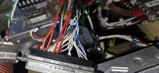

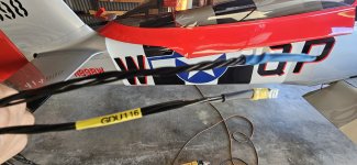

4 Power Leads to GDU 116B
4-Lead Grounding Harness for GDU 116B
The GPS 175 required a new HSDB connection, so I opened up that backshell and wired it up.

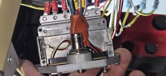

My original G3X installation carried the AHRS on the back on the GDU 460 and worked flawlessly. For the AXIS, the GDU orientation is moved counter-clockwise 90 degrees. So after all of my wiring was tethered and the continuity-power checks completed, I had to make a few adjustments to my plumbing behind the unit. For the most part, the installation came out fairly clean. All of my G3X harnesses had more than enough service slack to make the needed connections.
When it came time to throw the switch, I wasted no time peeling off the plastic and turning down the lights. That glass is sweeeet! Without even moving into the first steps of configuration, I can tell you that the definition of the display blows away anything I've seen before. The pictures here do it no justice at all. Just take my word for it: When somebody uses the term High Definition, this is most definitely it.

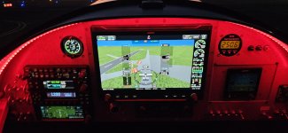

After a long, hot day in the hangar, where I spent the better part of my Friday morning and all afternoon in the AXIS Configuration process, I watched the end of the week fading off with the sunset and decided to make a first flight with my new AXIS system.

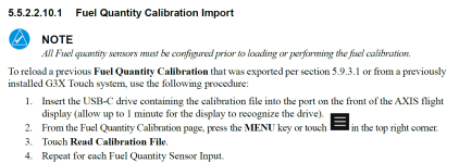

I was not able to transfer my fuel level calibrations from the G3X over to the AXIS system for some reason. There is an Advanced Import feature where you are supposed to be able to transfer individual calibration curves---like from the left and right wing tanks---from the G3X calibration files that were saved before the GDU 460 had its plug pulled. I followed the directions to the letter, even making sure my USB-C memory stick was formatted to FAT32. I tried 3 or 4 times and failed, so I may have to resign myself to getting the tanks burnt off in the air so I can recalibrate the old-fashioned way: a few gallons at a time, one tank at a time. Later, I cranked over and taxied out to the compass rose where I performed the GMU 11 magnetic interference and compass calibration procedures. It was my first opportunity to watch all of my engine instruments come alive, and man, oh man, she's a sweet upgrade! After I brought the RV-8 back to the hangar, I completed the autopilot configurations and went though the ground checks with no squawks. As the redness of a dying day swept over the tarmac, it was time to get airborne with the new AXIS system.

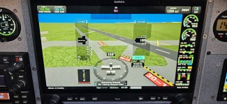

Taxiing out, the new 3-D taxi scheme came into view and diagrammed my airport beautifully. There was an issue with an RS-232 backup port not communicating with the GEA 24 which was already on the CAN Bus; nevertheless, the AXIS system lets you know in no uncertain terms when redundancy issues pop up. I may have to double-check the pinouts for that port to get them talking again.

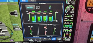

At runup, I noticed a vast improvement over the G3X for being able to read my EGTs during the mag/e-ignition check.
With everything checking out in the green, I announced for a departure to the west, taxied onto the center line, and let her rip. It was still about 95 degrees on the deck, so I was expecting a hot climb-out and kept my pitch pretty shallow. I wasn't planning on making anything more than a 15 or 20-minute flight anyway, so I shot for 4,500' and leveled off. I realized quickly on the climb-out that I must have missed calibrating my trim motors because my pitch trim was reversed and I had a non-calibration symbol emblazoned on the screen that I had not noticed before.

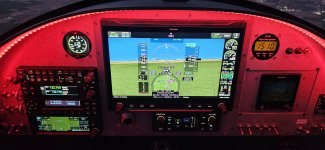

At least I was able to configure my PWM lighting bus correctly. As things got a little darker in the cockpit, I threw on the LEDs and experimented with the display for a time. I had not populated my upper status bar with all the elements I enjoyed on the G3X, so I added that to my list of adjustments, then flew back to the east as the city began to bask in the darkness of the coming night.
Back home after a 25-minute joy ride, I got to see for the first time how helpful the 3-D taxiing will be at unfamiliar airports.

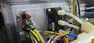

I see you kept the power for the GSU25 The same as the G3X.
The axis manual recommends that the GSU25 is not powered from screen but direct from the aircraft bus. Any idea why?

Hey, Trent,
I have no other use for those two power outputs on the J1011, so I decided to put them to work. Can you think of any better place to run those two wires? Maybe a lighting circuit? Anyway, I felt better about the redundancy of two power inputs rather than having to rely on a 2A fuse to power the whole GSU 25. As to why Garmin recommends the direct bus power, I don't know. That's a really good question. Maybe G3Xpert could answer that for us.
Maybe the output loses power if the screen fails.
If that’s the case:
I was thinking one input to the gsu from the PFD and one from a bus, for redundancy.

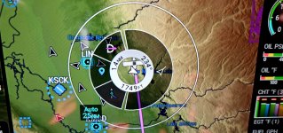

So, today's flight taught me something about that ADS-B traffic I mentioned earlier. That circle isn't showing vectors or separation at all. It's called a Range Ring in AXIS terms, and here is what the Pilot User Manual has to say about it:
Wow, that is a ton of stuff in there! I thought it had to do with traffic because placing my finger on the airplane symbol brought the ring onto the screen. Anyway, lots and lots to learn here, but it sure is a fun process!

The fuel calibration import is not done via the advanced import function, but via the calibration page for each tank. Not obvious at all…
You're right! It isn't obvious. Reading digital manuals and clicking bookmarks all over creation can lead to a lot of overlooked details at times, so thanks for the heads-up!
