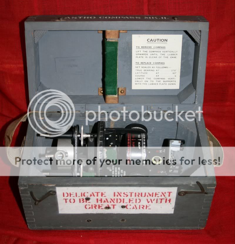

Hey I got that beat. The AstroCompass!
In college we had a navigation instructor who broke these out, and we actually got tested on how to use them...in 1988:
I saw one at a thrift store and actually bought it.
