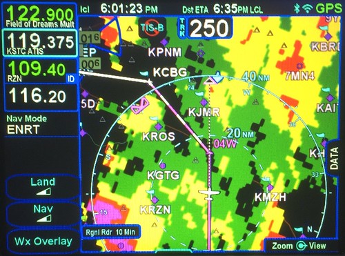

One option to think about is weather/traffic. Unlike Garmin products, the IFDs will take ADS-B weather and traffic in GDL90 protocol, which means you can connect a stratux via serial line.
This is a screen shot of my IFD, with the weather/traffic being delivered by a stratux box:
