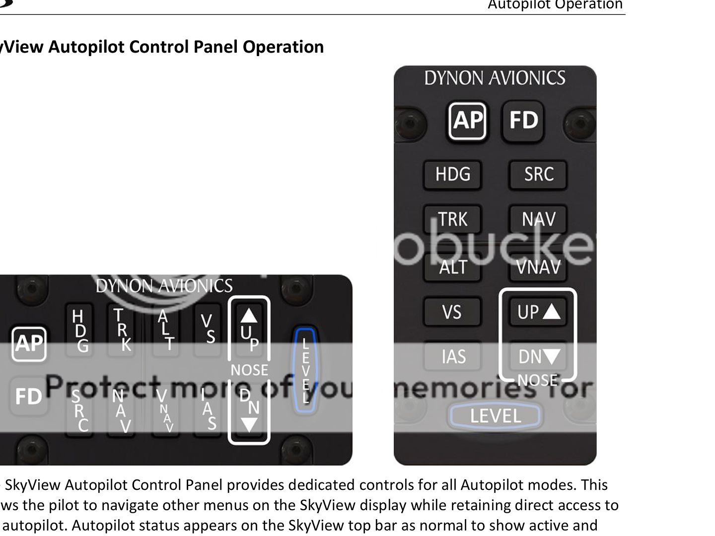

I have an RV12 SLSA with the Dynon knobs installed. I have the new Vans RV12 Presets installed but I get a message on the SV screen that "Auto trim is enabled but not installed." That P^%$#@ me off because that was supposed to be installed in my airplane and others with similar serial numbers have it installed.
So after getting over being pissed what do I have to do to "install" the auto trim wiring. Finding that in the Van's documents has proven to be following a rabbit trail with no dog:)

Do you have this panel installed? I believe its nesseccary for auto trim.:)

There is no wiring to do providing Synergy did what they were supposed to. The problem could be as simple as a configuration issue in the Dynon. Most likely, that is the issue. Call Van's and they can walk you through the setup. Give me a call if you want further explanation.

I got it done; the "installation" required a "configuration" of the servo movements. That was it.

We both have the Knobs panel and the A/P Panel installed. When SV 12.0 came out it provided auto-trim (if you have the A/P panel). I thought the software itself would 'enable' the auto-trim. Checking SkyView it said it was 'enabled' but not installed which seemed contrary.
After a few phone calls to Vans and Dynon, and discovering that Dynon updates the User and Installation manuals with each firmware update (well SLSA buyers weren't told!), it became obvious that the pitch servos had to be calibrated in order to 'enable' the auto-trim feature and so the 'enabled but not installed' indication was misleading at best. At least now calibrating the auto trim made sense, but still had to call again and find out whether an SLSA owner could do this or did a mechanic have to do it? I did it under the watch of my mechanic anyway.
I finally got Vans to detail the calibration procedure and they added it to the ReadMe file that accompanied their version of the Dynon firmware update.
The calibration is simple and straightforward (once you KNOW) and I got my auto-trim to work.
