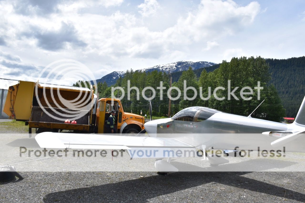

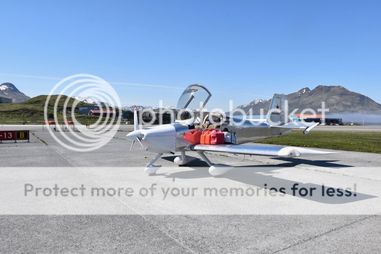

Russ it's hard to beat plastic cans while on the road. I tried flexible tanks what a pain in the neck to fill at the stations and then empty into the tank. Next to impossible without a spill it's always windy. It's never right flange it's often a rush. Nobody wanted them and tossed them in the trash :) If you are traveling alone faraway (Alaska or BC for example) just keep couple of cans empty in the plane. Leave them with somebody if not needed anymore. I have left fuel cans at several locations through Alaska and Canada you can borrow them if it's within your range :D
I use a couple of 20 litre (5.2 gal) flexible rubber fuel containers to transfer fuel from the bowser to the plane. While I don't like carrying fuel in them in the plane, I've done it on occasion when the alternative was potentially being stranded at some remote airstrip in the middle of nowhere. I eventually increased the capacity of the fuel tank to overcome that problem. I agree with Vlad that rigid cans are a bit easier to fill, but on the other hand the flexible bags empty much faster. Never had a problem with spillage.
