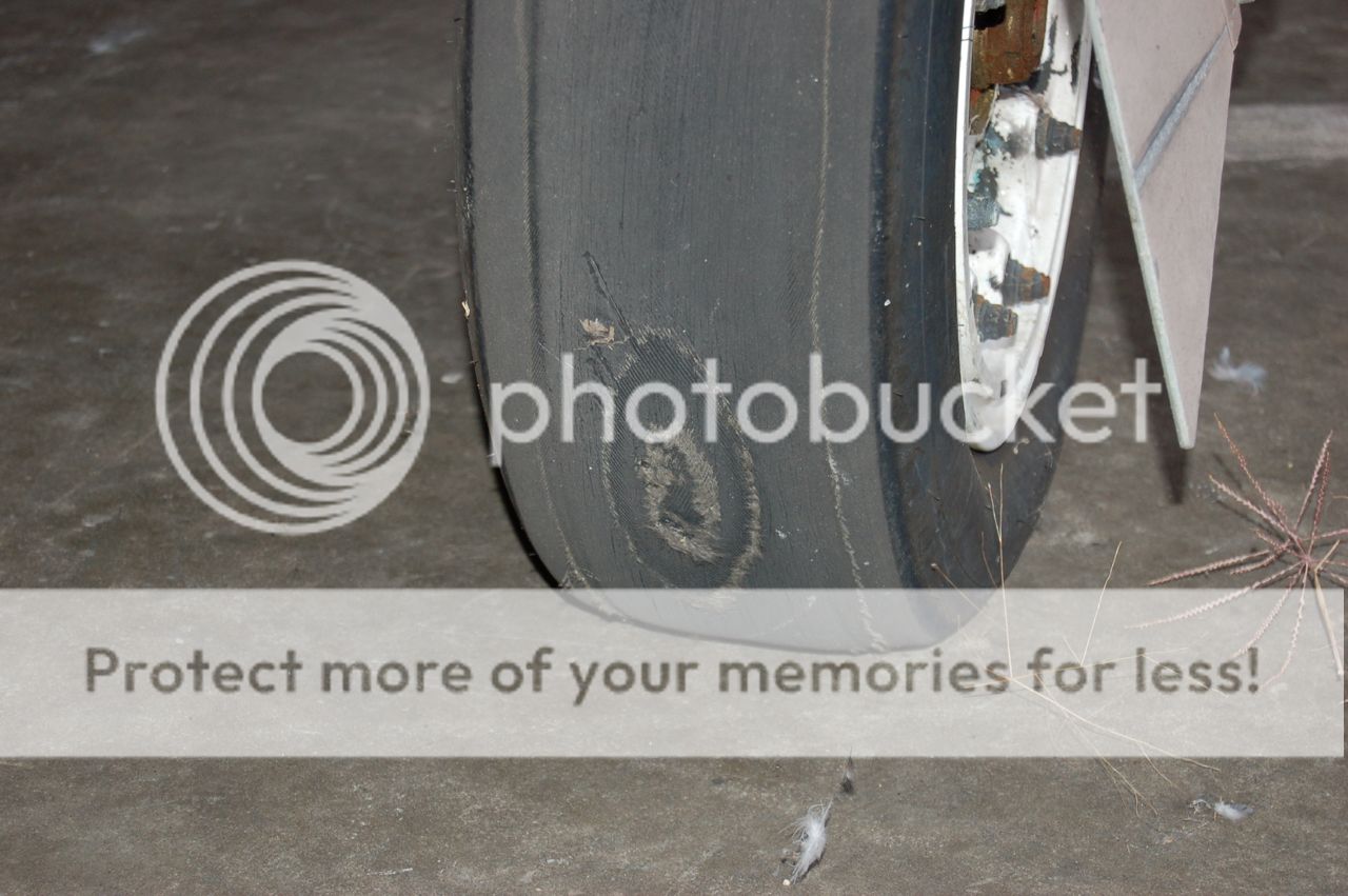

Enjoyed this one. You probably saw my first set of stock tires Scott. Squoze 1K+ landings outta dem. :D
That photo must be of one of the other (FAST) airplanes you used to fly Vlad, cause it doesn't look like an RV wheel/tire.
Actually, if I am remembering correctly, I think a tire is still technically airworthy if it has worn through the first layer of cord material. If you hit the second layer, it must be replaced (The one in your photo looks way past that.....).
Ran one of mine that far, by accident..... And it blew on take off. Bad idea.
