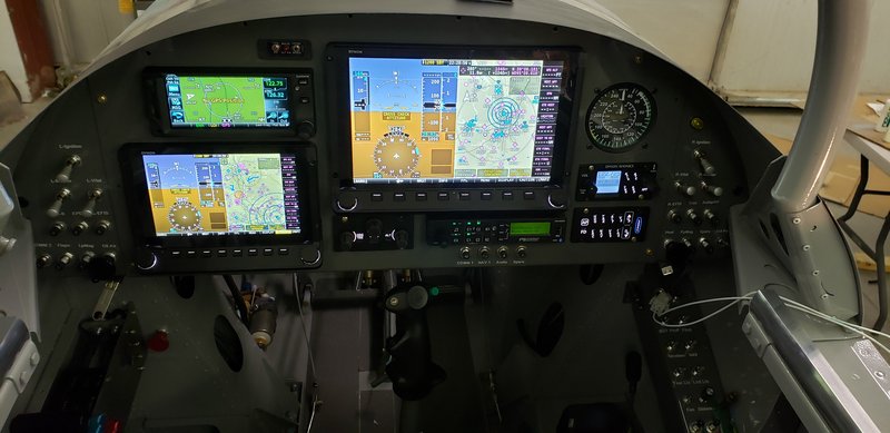

Photo is what I'm flying in the RV-8.
Carl
