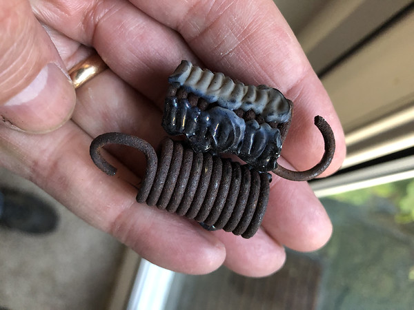

2 RV12's
Both shed exhaust springs within 10 hours of new despite lathering with silicone as per plans.
Just lost another 2 on start up today. The ramp lads presented them to me when I got back. They just crack at the base of the curly bit and fall off.
These OEM springs are just garbage and need flagging up via MOR or similar.

I installed GPL STAINLESS STEEL EXHAUST SPRING FOR 912 SERIES from Aircraft Spruce - $4 ea. Springs were slightly longer than stock so requires bending the welded tabs to get correct stretch. I filled the center of the spring with high temp silicone. Springs have been fine for 400 hours...
Another 500+ hours and 7 years flying without a broken spring. A precaution I always take is to never use anything to remove the springs that will scar or gouge the spring hooks. IE, no pliers, Vice grips or screwdrivers! These springs are highly stressed parts and even the smallest surface scratches are stress risers that can lead to hook failure. I use a circular cross section hook tool I made from 3/32" stainless wire.

This is a snap of the springs..... They have been on for 12 hours !
The Aircraft Spruce springs are 304SS, which has poor resistance to chloride. So if you're in a salt-air environment, you may want to look for 316SS springs, or have some made, or make them yourself.
