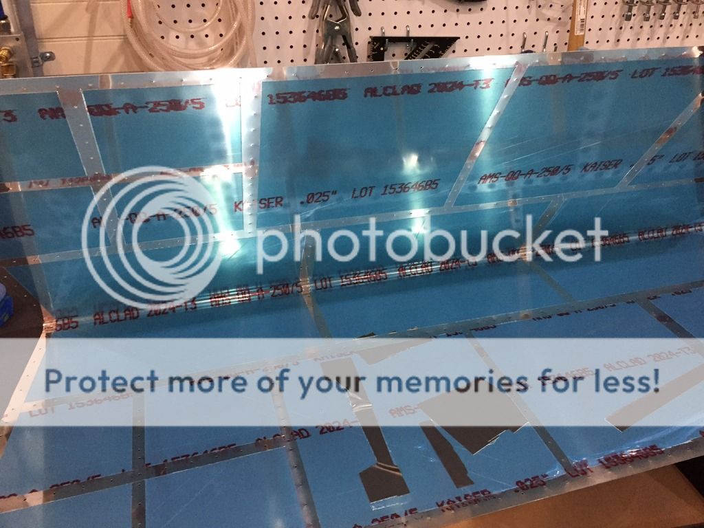

I just spent the last two days prepping and priming all the internal surfaces on my empennage kit. Somewhere during all the scrubbing and rinsing and spraying I was thinking about the prime / don't prime debate. I've heard convincing arguments on both sides by people whose opinion I value, but I have yet to come across anyone who offers proof that priming isn't necessary. As in, I've never seen a picture of the inside surfaces of a vans aircraft with 'X' amount of hours. A control, if you will.
I've primed all of the internal surfaces. I started with water based primer and moved to Akzo after the tail kit. It is a lot of work with the prep but I think it's worth it. I'm not sure I'll ever build another after this one so I want it to last.
And I'm doing the same thing, but is there any evidence that they don't last if you don't prime? You would think if primer actually did make an airplane last so much longer there would be tons of anecdotal evidence of corrosion issues on unprimed alclad parts. Maybe there is. Is there??
No photos, but my 41 year old Bonanza has mostly unprimed internals and is doing fine. It's had some corrosion removal over the years but all those have been on external painted surfaces, especially where skin overlaps and where there is a lot of "splash" form the landing gear. It has spent most of its life in Florida.
That said, I'm priming all the internal parts (ribs, etc) and the parts of skin surfaces that they touch on the RV-14A I'm building (not priming the entire skins, just where metal is touching metal). I use a soldering iron to remove the plastic on the inside (same as on outside) along the rivet lines and remove after priming. Reasonable amount of weight, seems prudent living near the coast and doesn't take an inordinate amount of time. My approach to is scuff, clean and use self-etching rattle can primer.

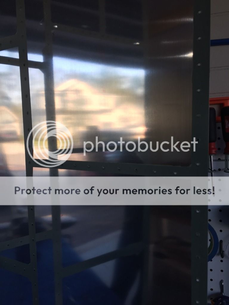

Vans test sample
Not an interior surface but it is a valid test.
http://www.vansairforce.com/community/showpost.php?p=1117952&postcount=12
I sprayed everything inside with it. Cabin parts were sprayed with Jet Flex SB within 30 minute window of P60G2.

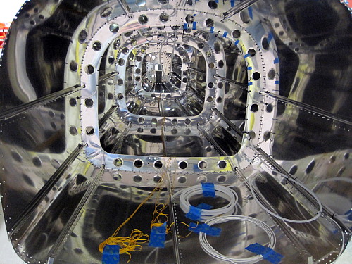

As for a picture, here's the tailcone of my RV-12.
It will probably look that good 20 years from now, long after I'm dead.
