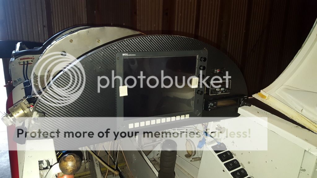

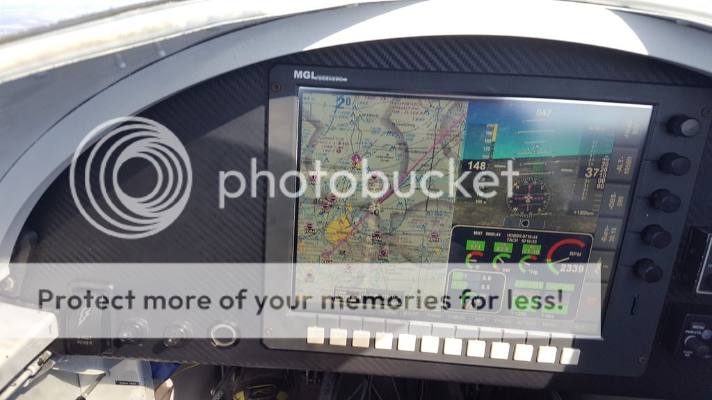

I went ahead and built a whole new panel for my rv4 and installed a challenger lit. So far i have about 4 hours on it and love it.
I usually don't really want to see posts about a product from people that haven't actually used it in its intended environment... I guess I'm a hypocrite... here goes:)
Bought 10.4" Challenger light that will be going in a M14P powered Moose. Getting to know it pretty well sitting in my chair with it hooked up to a battery... good way to get used to it I believe. Very user friendly. Menus make sense and very adaptable to different types of sensors. Lots of options... a good thing. Can build your own screens for the computer nerds... not much of that in me unfortunately. Also have the V6 radio and it also seems user friendly considering its size 2.25" round. I plan on installing the 8.5" Explorer in my RV6 as soon as the funds are available. Matt is very knowledgeable, friendly and quick to respond. Hooking the whole thing up is a piece of cake with the CAN network! I'll be using the 4.3" Extreme EFIS in the Moose also, co-pilot side. Excellent little unit! It too is VERY user friendly and many functions and adaptable! Playing with it on the couch also. Glad to hear people like it.
