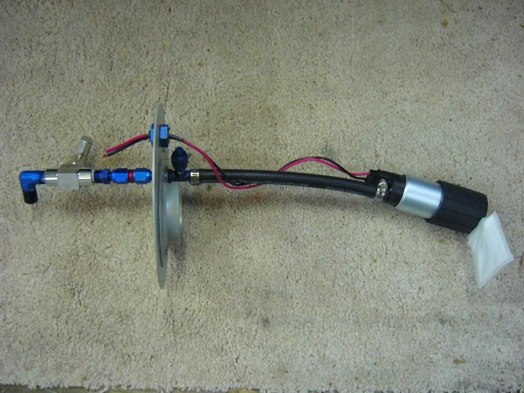

The pump system consists of an automotive in-tank pump from TRE Performance (thanks to the idea from Alan of Anti-Slat), a home-made pressure regulator, and a flow regulation valve obtained from McMaster-Carr and Marvin Helmsley’s injector nozzles. Standard aircraft hardware was used throughout.
[/URL][/IMG]

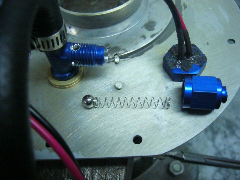

The pressure regulator was made from a bulkhead run “T”, with the side leg bored for a ¼” ball and a fine spring for pressure control. Bleed holes were drilled at the relief point. The pressure regulates to 32PSI.
[/URL][/IMG]

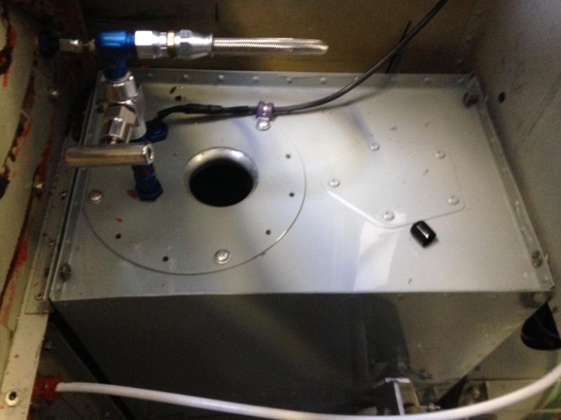

The tank fits into the drop area of the forward baggage compartment.
[/URL][/IMG]

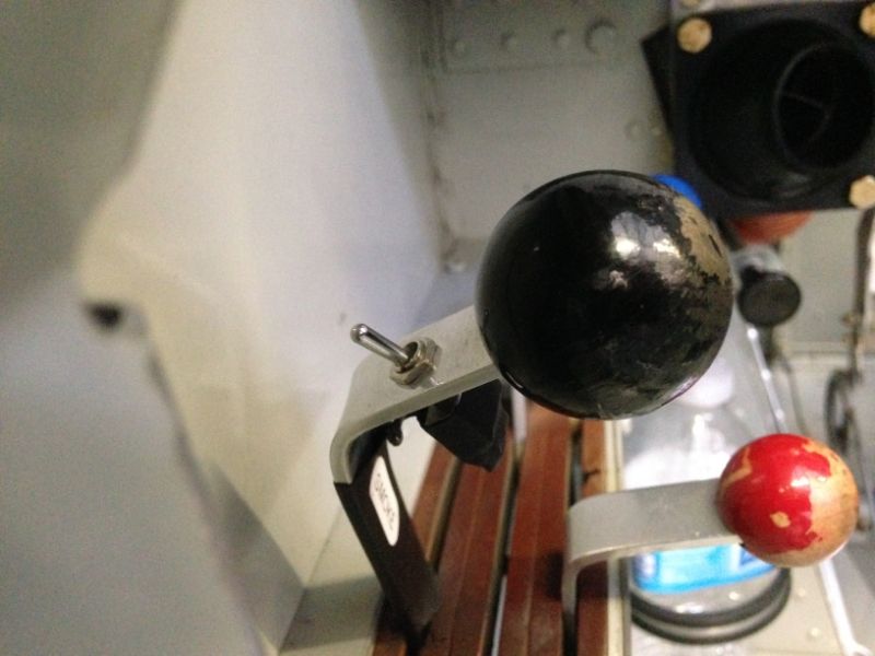

The system is controlled by a relay, which is grounded through a switch on the throttle. Power is supplied through a 15 amp circuit breaker and a smoke "arm" switch on the instrument panel.
[/URL][/IMG]

Since the firewall forward line to the left side of the engine is longer than the line to the right side, a flow restrictor orifice was inserted in the bulkhead “T” outlet serving the right side of the engine. The outlet was drilled out to 3/16” to a depth of 1/4" and a number of restrictors were fabricated for test. We ended up using a restrictor with a 1/16” hole to get balanced flow to both nozzles.

Neat system. Especially the submerged pump. I think you will find the in tank pump will have difficulty making the flow rate you need for good smoke at speed. Your flow rate needs to be at least 1/2 gal/min. It takes a pretty big pump to do that with oil. Let us know how it compares with your other smoking friends in the sky.
I think you're onto something with that submersible pump! Can you tell us the rated flow and pressure?
Submersible pump
The pump is from TRE performance (www.treperformance.com/fuel pumps $70.) and is rated at 255 liters/hour (67.5 Gph) at free flow and 210 L/hr (55.65 Gph) at 35 psi. Typical usage as pointed out by Kahuna is .5 G/min or 30 Gph. The pump is a positive displacement type, and is capable of 140 PSI at 5 Gph. Therefore a pressure regulator is required. At 35psi the pump pulls 10 amps, with the draw proportional to pressure. It might be possible to use a smaller version of this pump to cut power consumption

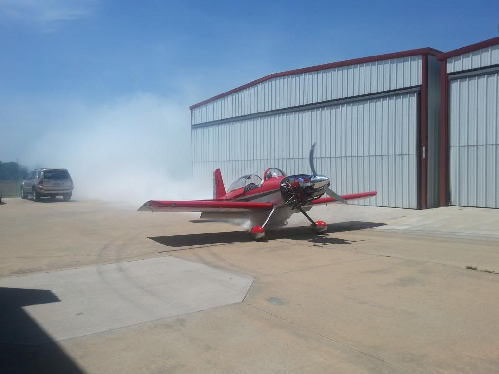

Inflight smoke photo
Kahuna,
This photo was taken in flight this morning. We were out doing a bit of tail chase. Do I need to add more smoke oil?

Smoke looks good to me. Your getting the flow rates as measured on the ground.

What did you do for a vent?
You obviously have one or it would collapse the thank, we just don?t see it.
What I did for my removable tank is to install a -4 AN bulkhead in the bottom of the fuselage below the rear baggage, the make up a small piece of 1/4" aluminium hard line bent in a 90 facing forward, flare, and attach to the bulkhead fitting. Looks like a mini pitot tube.
Internally I used Summit Racing braided steel over nitrile (over kill I'm sure) and ran it up the back of the rear baggage and out a hole with a grommet. I used Summit Racing a -4 AN female hose ends and a quick disconnect fitting similar to what people are using for aux fuel tanks. In fact, I intend to use the vent for a removable aux fuel tank as well when needed.
Its kind of cool after running the smoke to pop the cap on the tank to refill it and have a bunch of smoke come out of the tank.
Be careful not to create a siphon. Don't ask me how I learned that one. :eek:
Vent on home made smoke system
I used a standard Van's fuel cap. Inside the big "O" ring and between the cap halves is a small chamber. By drilling a 1/16" hole in the upper and lower halves, a surge chamber was created. We the drilled and tapped the upper half for a 1/8" pipe and installed a vent filter normally used in the brake fluid reservoir. The aircraft does not have an inverted oil system, so negative "g" is avoided. So far the vent system is working great. It would easy to use a pop rivet vent to the outside do the aircraft for an inverted system. I have to credit the idea for the vent system to Mel McGyver, a retired mechanical engineer who helped with the smoke system installation.
