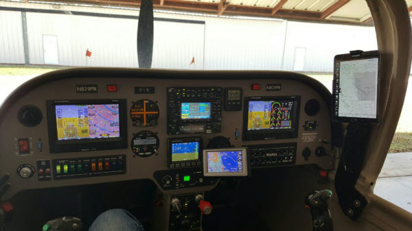

+2 for the FREE FltPlanGo app. My SAMSUNG GALAXY TAB S2 is mounted on the co-pilot side.
It is an awesome combination, especially since all the updates are FREE and it works with just about any ADS-B in unit to include the DYNON SkyView WIFI module.

I'm running iFly GPS on an iFly 740, Samsung TAB S2, and Windows desktop. One interface for all! I plan on the desktop, transfer the plan to the Tab S2, then in the cockpit I transfer it to the 740. The 740 is brighter than anything else, the TAB S2 can connect to anything anywhere. Works for me.

FltPlanGO works for me. I've mounted a Samsung S2 7" tablet on my side of the cockpit and a 7" Samsung Tab A on my wife's side of the cockpit. Both work very well, although graphics functions (panning, zooming) are slower on the Tab A. I store all the chart data on internal SD cards as I carry the entire chart package for North America (VFR & TACS) as well as all of the instrument charts for Canada on the device.

Nothing else compares to the iFly 740 for screen brightness and readability in the full sun. YMMV
I'll be shooting some GPS (VFR) approaches with the 740 tomorrow to see how it goes.

very pleased with GPS (VFR) ILS approaches. the CDI makes me legal and can use the ifly 740 for assist if needed.
BTW: take a look a the iFly GPS REAL PLAN (beta). it will blow you away. great.
