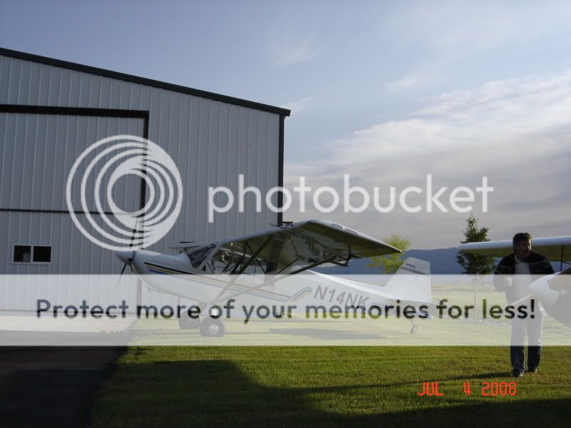

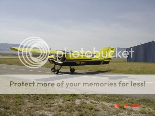

I am certain Rans has S-LSA models of the S-7 and the S-19 (and possibly the S-6). This allows people to build E-LSA models per factory guidelines. new info suggests I am wrong
Here's a link to Rans first S-LSA , a S-7.
http://www.rans.com/_KITS/NewsPages/FirstS-7LS.htm
I've got some memorable hours in this plane.
Next is a pic of the S-19 S-LSA, I took of my friend, Neil after our demo flights in Utah.
And finally here's me on first taxi test of a S-6es E-LSA. (although built under the exemption rules). I think Rans has a S-LSA version now
YMMV
