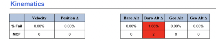

I?m having a low-level Baro Alt problem with my uAvionix ADS-B installation. Most PAPR?s are good but some come back with close to 2% Baro Alt error and are marked red for failure. I talked with FAA ADS-B folks at Oshkosh last week and they said problem is intermittent with my altitude encoder reporting. So maybe encoder is bad or wiring problem. See post http://www.vansairforce.com/community/showpost.php?p=1362932&postcount=21

Most intermittent problems are due to bad connections.
Unnecessary altitude encoder connections can be eliminated in your plane by bypassing the control board.
To do that, connect Pin 13 of the D-180 EFIS 25 pin D-Sub to the transponder encoder input.
Also connect ground Pin 16 of the D-180 EFIS 25 pin D-Sub to a transponder ground.
The extra ground is redundant, but will not hurt anything.
The above may or may not fix the problem, but is worth a try.

It may not really an alt encoder problem. I recently installed a uAvionix EchoUAT and SkyFyx, and (surprise!!) have BARO ALT errors showing up in the PAPR. Unless you wired the serial data from the transponder to the uAvionix device, it monitors the transponder signal to grab the squawk and altitude data. There is a setting for the sensitivity of the transponder monitor. Here's a quote from the email I received from uAvionix support:
Adjusting the threshold value on the echoUAT can improve the performance of the transponder monitor. uAvionix does not recommend changing the value unless directed to do so by uAvionix.
The threshold value adjusts the sensitivity of the echoUAT transponder monitor. Higher values reduce sensitivity, lower values increase sensitivity.

Yes, I'm familiar with threshold monitor. I tried for several months to fine tune this setting with some good / some bad PAPR and finally decided to hard wire the transponder with uAvionix supplied MUX cable. So now I get a low incidence of Baro Alt failure. About one out of ten flights gets a red box on PAPR.
As a side note, I talked with FAA ADS-B specialist at Oshkosh last week and he said I should continue to try to fix the problem but FAA would not reprimand me if the problem doesn't get fixed. He said they consider this a low level problem.

I believe that is old information. I have been told the boxes come out of the factory now with the threshold set at 1350. I had to go lower to get good ops.
On some transponders you can trigger an output for testing purposes by tweaking the mode knob into the ?test? position.
My observation is that the Baro Out data is the first thing to fail if you are in a marginal coverage area.
