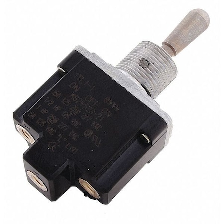

If you're looking for the best switch the Honeywell 2TL series is most reliable switch I know of.
I'm with Walt. Those Honeywell TL switches are the best. They even look higher quality. I bought most of mine at Onlinecomponents.com for the best price.
The switch will have the rating stamped on the body of the switch. The rating is something you should know. A switch is not a switch. Do you have a contactor? If so do you have a protection diode on the coil?

This is the style that caused my problems. I would replace as soon as possible!

It is not a standard practice to fuse this lead from the solenoid to the mater switch because there is not a meaningful risk of current beyond the chasis wiring's rated capacity.
Larry
