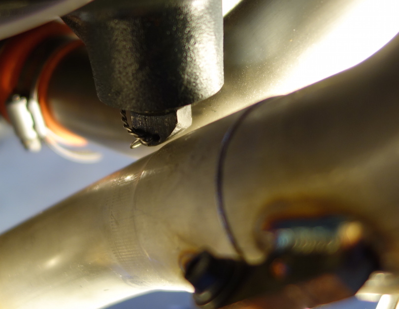

I have an ECI motor with their cold air sump along with Vetterman's 4 pipe exhaust and am getting interference with the exhaust pipe for cylinder 3 against the right side oil drain plug. I ground down the plug a ways and can get 1/16 clearance, but I don't think that's enough. See photos below.
Clint confirmed my thought that maybe I should go with a flush mount plug. My worry is that I then could not safety wire it. I've been doing a lot of digging and can't find allen socket plugs at Spruce or Wicks. Nor do I see them mentioned on VAF.
Would this be a safe option if using Loctite to secure the plug?

Plug before:
After, with exhaust in place:
Solution?
You can get plugs with a hex top which are shorter. May work...

Not sure how much clearance I should have between exhaust and plug. If I went with a shorter head, I could get maybe 1/4" of clearance. And who knows how short the head would be. Depends on how far the NPT threads went in at the proper torque.

Russ the plug need to be safetied somehow. It's quite massive comparing to other engine ports and locktite is not a good option. In my opinion the type of plug won't work. There are other low profile plugs (for allen wrench) on some European cars where the head could be drilled for a safety wire.

On your engine, the left side plug is way to close to the 4 stack exhaust to make any meaningful method for draining. The drain is right above the stack. You can fit a 90 in there to AN fitting, then put a cap on it. We use these 90 fittings on our Titan engines for the inverted system. But still, you will be dumping on the exhaust making a mess.
On the right side of your sump is a drain fitting that you CAN fit a straight quick drain valve to and your home free. Another alternative is the rear sump fitting. But that once again dumps on the exhaust making a mess.
Here is a shot of one of our motors that should be the same sump as you have. I think. You can see the 90 fitting over the exhaust. Works fine for inverted system, but not good for a drain. The right side drain has plenty of clearance for a drain.
Below is a shot of the right side sump and drain location that you can put a quick drain on.

My configuration has the #3 exhaust pipe running so close to the drain plug, there's no way a quick drain plug or AN 90 degree fitting would fit. I was thinking an alternative was dimpling the exhaust at the plug like you see on many automotive headers that are near things like the steering rod.

Tighten the secondary plug that is causing your issue, move the safety wire whole... (drill it further back) and grind away on the plug till you are happy. Done... :)

I think I came up with a solution to this interference: Drilled a new safety wire hole closer to the base of the plug, then cut and ground off the excess.
Drilled new hole. Note earlier attempt at grinding clearance that was insufficient:
Excess cut/ground off:
Now we have some decent clearance. About 3/16":
Ready to go:
