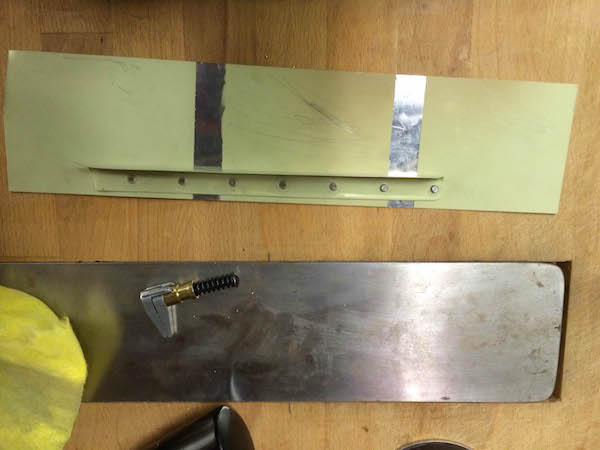

Hey.... So for the better part of 6 weeks I have been pretty busy fighting my own little prime war!
So this is just what the result of all that time and money is.
1: I tried Auto Dupi Color Rattpe can (grey) non etching - easy to use, cheap, scratches easy, dont like the color
2: I tried waterborne Aviation primer (non toxic) with HVLP gun - Looked good, expensive, did not stick well at all. Came of with duck tape and scratched easier than rattle can. Was a real pain to get to spray right. either to runny or to coarse. PITA INMO
4: TRIED REALLY HARD TO GET AKZO....Cant get it here, would have to import, would cost over 400$
5: finally decided on a Aviation high solids 2 part epoxy that looks similar to akzo but less toxic I think. does contain Cromates. also expensive but not as bad as Akzo...
Results: Used it on scrap metal for testing only. Spays really nice and easy. any runs and orange peeling I thought I had on parts disappeared after drying. I Like that.
Now How durable is it? how durable is other stuff? Anyone want to look at this video and see what I got? This was after 24h after spraying. I had expected it to be tougher... but maybe this is just how all primers are. Maybe it will be better after a week of drying...
Video scratch test
download
---No need to get popcorn. I have decided I want to prime and now I will use this stuff because I am not buying a 3rd type of primer. Just wanted to see what other stuff is like. because I keep reading "tough as nails" on all 3 products I have used....

Couple of questions.
1. What was used to test adherence and scrating?
My test is a piece of Gorilla tape. Rub it on, leave it overnight then rip it off.
Scratch test is my wife's fingernails.
2. What's the prep process. Aluminum oxide forms pretty quick and is the enemy of adhesion. My preference is maroon scotch brite, dimple, wash with Bon Ami and grey scotchbrite, rinse, dry, spray.
I use P60G2 primer but that's another war.
The epoxies might need more than 24 hours to reach full strength, especially if the temps are under 70F or so.
Re-try the epoxy scratch/tape test after a week of curing.
Just to clarify
My process was just 2 pieces of test so I did 3 different prep works hence the 3 different areas on the picture to see what works best.
1. just aceton wipe
2. Aceton and manual scotch brite rub
3. the thinner supplied with the paint and manual scotch brite rub
this was done less than an hour before paint.
Result: honestly I cant even tell the difference.
I used my nails (leaves marks but doesn't go to metal)
and my Keys as shown in the video. (it will eventually go to metal)
Paint temp wasnt ideal so yes I will give this a couple more days and see.

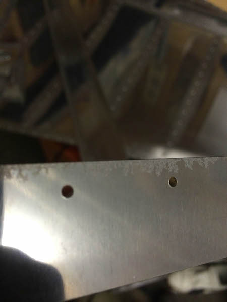

Take a quick google on filiform corrosion aluminum. Also take a look at Ch6 of AC43-13 which you can download for free. Its a good treatise corrosion and corrosion mitigation wrt aircraft (just one of the fed works on corrosion) Not the be all and end all, but a good starting point. Doesnt cover some of the ACF, Corrosion X post build type of remediations/mitigations in use these days however.
BTW noone learns about corrosion until they come across it, so dont think youre behind the curve or anything. I didnt know anything until I found some corrosion pits on my wing spars. Then someone else showed me the references and such. Yea for VAF! :)
