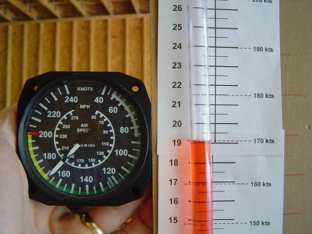

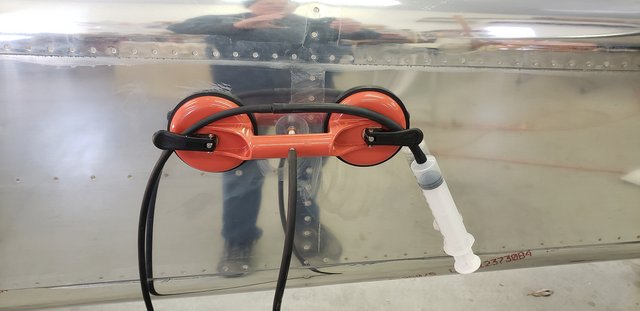

If you want to do your own static system leak check to find leaks, here is a test rig made from Harbor Freight stuff.
While most EFIS airspeed indications are accurate, Van’s analog airspeed instruments are notorious for been poorly calibrated. Make a test rig to see what you have. This simple rig is amazingly accurate. Google details.

1. Use an apparatus similar to Carl’s first photo to draw a slight vacuum. Don’t forget to tape off or otherwise seal any additional static ports. Systematically hunt down and fix the leaks. Or pay a shop to do it for you.
