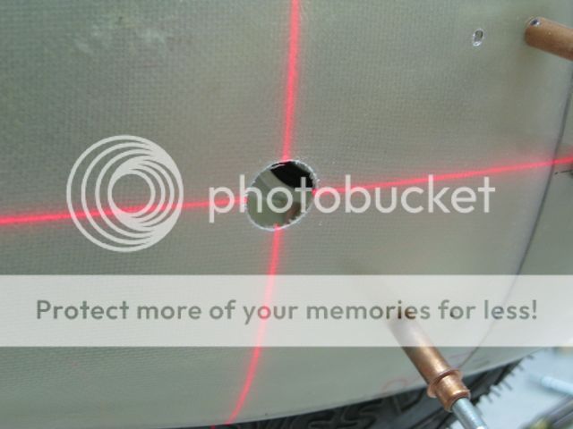

I have an RV12 S-LSA with wheel pants. Does anyone have a picture or diagram of the size and location of a hole in them to facilitate checking tire pressure and airing up the tires?

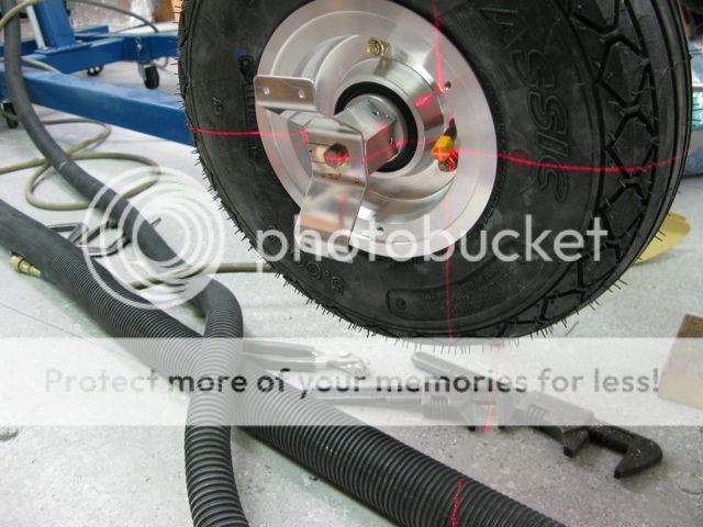

Use the hole on the forward end of the outboard wheel pants bracket. Remove the pants and the outboard bracket, screw the forward section of the fairing to the mount and trace the hole onto the fairing and drill with a step drill. You can get a steel or plastic plug at a hardware store that will push in and can be pried out. Mine lined up very closely to the valve stem. You can also line your valve stem up where you want it and mark your tire with a paint stick for quick alignment. Can't comment on the documentation required.
For what it's worth...
El-Cheapo lazer
Aim it at valve stem
Put on wheel pant, transfer hole location
Hole size to fit either hardware store chrome plugs, or stainless spring covers from an aviation supplier...
