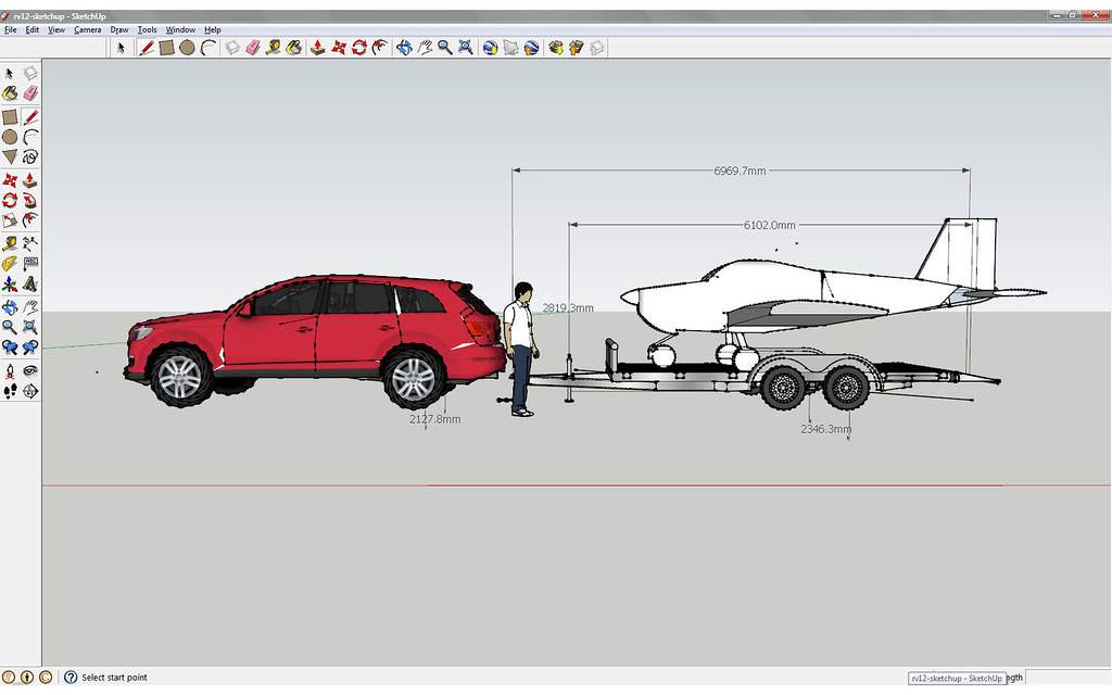

I'm working on a sketchup cad drawing, and I've everything else exept an RV12 in 3D, so in true fashion I'm now distracted and working on a 3D RV12. 80% there.

I now have a 3D model of an RV 12 in sketchup I just need to work out how to post it
How wide is the wheel track on the 12? You might not be able to get it in between the wheels on the trailer.

The trailer pictured above is significantly over-designed for the application of transporting an RV-12, IMHO. I did not have sheet metal forming capability at the time (1985 - 1991), so the trailers were made of welded steel tubing trusses. With sheet metal forming capability an aluminum trailer could be designed that would be (slightly) lighter. I suppose one could also come up with a design that Huck-bolted together so it could be sold as kit and assembled in a weekend.
The outside dimension of the wheels just fits inside the standard car trailer wheel with the fenders on. Several of us have had no issues moving them on car trailers to the airports. Vans must have figured that in.
