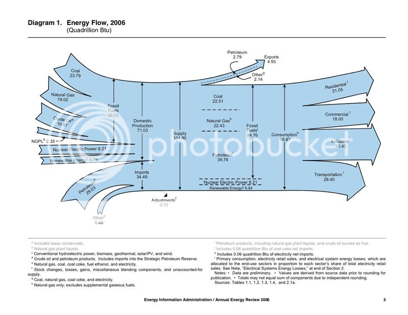

Energy Flow in the USA 2006
I think in any discussion of this type it is nice to have a look at the big picture:

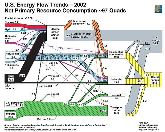

Also here is some detail on what goes to what:
I think that if we increased nuclear by a factor of eight, and renewables by a factor of three, then we could keep more of the nice energy-dense petroleum/coal liquefaction/natural gas products for the transportation sector. The clean (zero air emissions) nuclear-generated electricity could take over a lot of stationary energy needs now met by coal/NG/petroleum, leaving more fuel for boring holes in the sky!:D
