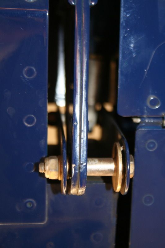

I have previously made two "safe" attempts at addressing these seemly draggy locations and both failed. One was to cover the top hole with a thin aluminum plate that moved up with the aileron at the wing tip and the other was to flush plug the recesses in the ends of the flaps and ailerons. I have rationalized a cause for the failures similar to holding a bottomless cup into the wind out of a car window compared to the same cup with a bottom in it. In both cases the inlet was unaltered but the outlet was closed or choked down. There is rational thought that says they should have worked but experiments and testing showed otherwise.
I don't know how much can be gained in this area but I'm convinced if there is anything it is on the inlet and shape of the structure on the bottom of the wing. This is a worrisome area because the constantly moving roll control surface is right there adjacent to the possible drag area. I have seen this addressed with fiberglass fairings on a very fast RV-8 and the well known owner who shall remain nameless told me they weren't worth much. Still, I don't have anything better to look at at the moment and I have three weeks until the next race. Yesterday, I got under the right wing especially the outboard end of the aileron with some 0.016" 2024-T3 aluminum and some tools and fashioned a square edged fairing that would cover the back slanting mount and the width of the opening and could be mounted with screws to make it serviceable. It looked neat but it occurred to me that the resulting ramp would be several times wider than the mount. I could rivet a rounded solid leading edge to this and I ordered a couple of feet of bar stock just in case I decide to go this way. There is a more wedge shaped fairing possibility but this could change the direction of the air flow and actually force more of it into the gaps for control movement - vertical parallel side walls seem best. I can still put on the modeling clay and give fiberglass a shot as well. Ice and improperly mounted fairings in this area could cause serious problems.

Bob, I just spent a bunch of hours in this area blanking off the flap, aileron and wingtip ends and mounting Vic's hinge fairings. (Vic's fairngs are excellently crafted pieces and effectively close the large opening in the hinge area).
I tuft tested the upper side of the inboard aileron hinge area before and after mounting the fairing. Tuft testing showed a significantly smoother flow on the top side of the aileron hinge area with the fairings.
However, I did not see a measurable increase in speed, either as a result of the end closures or the fairings. If there is a speed increase, as intuition says there must be, it seems lost in the clutter.
I would suggest that figuring a way to close the bottom to top opening in the hinge area would be beneficial. The additional frontal area produced by the fairing looks to the eye to be significant, and if it could be avoided while still closing the opening, you might be ahead.

Your test results with the closed recesses at the ends of the ailerons and flaps reinforce what I have found so far - no increase in speed. In fact, my tests showed a decrease in speed using the same test method as you describe. I'm starting to recognize this as a science project with very little hope of an increase in speed.
Your tufting observations are especially interesting. My plan on this particular project was to minimize the flow path from the high pressure lower side of the wing to the low pressure upper surface of the wing through the gaping holes around the aileron mounts and fair in the aileron channels that have the open ends facing forward and attaching to the wing aileron mounts. Your results are at least an indication that with you Vic's fairings you achieved that with no increase in speed. That is what I had been told by another very fast RV-8 builder/racer about the results he achieved with his "canoes" in these four areas. If I continue with this it will be more in the nature of an exercise to expand my knowledge rather than an honest effort to increase speed. Certainly not worth rushing to implement before the race in Pagosa Springs on September 22, 2012 three weeks from now.

I spent some time at the hangar after changing the oil in the truck and dumping it in the collection tank at the airport. I think just closing the majority of the holes flush with the wing skin is the way I will go on this.

I've plugged a similar hole on my Cessna 180 (the hole for the tailspring support tube) by just covering it with a piece of tape. It's stayed on for more than 15 years now. Simple, light and adequate.
Of course my IAS has generally been under 175 mph and the boundary layer there is probably thicker on my plane. Still worth trying.
For the flat parts of the gaps - one piece of .016 attached to the skin for the flap half of the gap, and maybe another to extend the bottom skin of the aileron leading edge inboard to the fitting. Your aileron deflections in a race are probably low.
