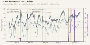

When my plane is parked, an X-sense temp/humidity sensor hangs from the oil cap and data-logs the "weather" under the cowl.
I've tried to crash Claude (it didn't) by giving it a pretty challenging task to build a humidity model for the crank case and tally the "wetting" hours. The model estimates when the conditions are ideal to form internal condensation, as well as count high humidity hours - the crank case dewpoint within 2 degrees. It takes into account engine metal mass inertia and exchange intertia between ambient air and the crankcase (the engine "breathes" outside air when temperature and air/vapor pressure change).
The code detects flights by finding sharp temperature raise (ie when I hang the sensor after the flight in a hot cowl) and resets the wetting counters. If the sensor data feed drops out it falls back to the closest AWOS station and inserts an uninsulated T-hangar buffer to estimate under the cowl humidity and temperature (fitted by comparing 1 year of X-sense data with the AWOS data).
This is packaged in a claude skill, a standalone python model, and as custom Home Assistant Integration. Home Assistant recalculates every hour and alerts via a telegram message and suggests to go flying after 2 hours of condensation is suspected, or 8 hours of very high humidity (thresholds adjustable, but the default tries to error on the safe side). It attaches a chart to the message showing past 2.5 month history of "wetting" events and marks the flights. Also alerts if doesn't see a flight for a month following a condensation event.
https://github.com/k3it/lyc-engine-moisture-exposure-analysis
pushed everything to github, including the physics explanation. The claude skill is packaged under the Releases.
This was meant to imporove on the "fly often" advice from lycoming by timing the dry off flights more accurately. Not sure if this is useful but was a fun "AI" project.
