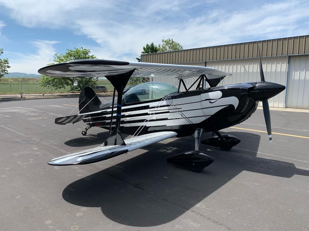

Stay EXPERIMENTAL my friends! The certified world sucks. This Christen Eagle II (ADSB exempt :D ) is my antidote to the constant BS of illogical certified aircraft maintenance restrictions.
