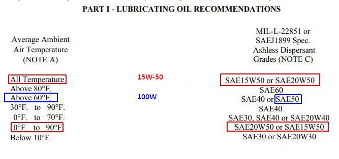

Look at Viscosity Index too. 15W-50's higher VI simply means it is less thick when cold and less thin when hot.
Lycoming says 20W50 or 15W50 are "all temperature". There is no reason to switch back and forth between straight and multigrade.

Lycoming also has an opinion. Texas and Alabama both have lots of mornings with crankcase temps below 60F.
