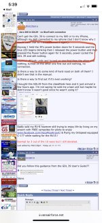

Can't get the GDL 39 to connect to my 660 or to my iPhone, although my 660 connected to my iphone (but I don't know why I would want that so I disconnected it again).
Anyway I held the 39's power button down for 5 seconds and the blue LED begins blinking then I released the power button and then pressed the Power button again for 5 seconds, power cycled the GDL 39 and still nothing.
I turned off both units and turned on one first then the other and nothing, turned on the other one first but still nothing, no connection.
Is there a way to do some kind of hard reset on both of them? I didn't see that in the manual.
Is there a way to find out if it's even working?

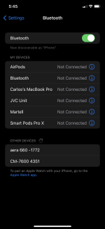

I bought this GDL39 from the classifieds here and it just arrived a few hours ago. I'm not saying he sold me a bad unit but maybe he didn't know it wasn't good since he wasn't using it?

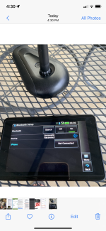

I also clicked on the 660 :
Forget all devices
Restore Default
and then did a search and the iPhone and the TV DVR show up but no 39

I just tested this by powering up both the GDL 39 and Aera 660, and then going to the Bluetooth Setup page on the Aera 660 and turning on Bluetooth.
It found the GDL 39 in a few seconds and paired with it when I pushed the "Not Paired" button.
If you have a hardwire cable, I would connect the GDL 39 and Aera 660 over hardwire and configure the Aera 660 connected serial port to Garmin Data Transfer. If the software in the GDL 39 is old(likely), the Aera 660 will automatically update it with the GDL 39 software it is holding (GDL 39 V4.91).

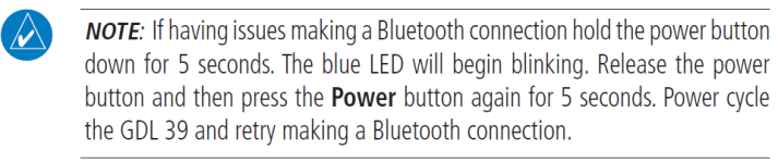

What we find in the manual "clears the device memory" and returns it to a "factory state" ready to connect. :
NOTE: If having issues making a Bluetooth connection hold the power button
down for 5 seconds. The blue LED will begin blinking. Release the power
button and then press the Power button again for 5 seconds. Power cycle
the GDL 39 and retry making a Bluetooth connection.
In this state it's like when you just turn it on where it's ready to connect automatically:

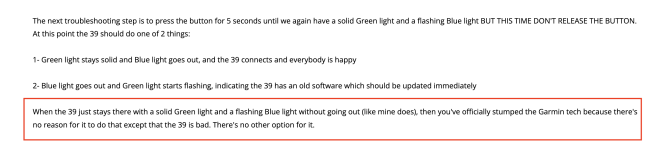

The next troubleshooting step is to press the button for 5 seconds until we again have a solid Green light and a flashing Blue light BUT THIS TIME DON'T RELEASE THE BUTTON. At this point the 39 should do one of 2 things:
1- Green light stays solid and Blue light goes out, and the 39 connects and everybody is happy
2- Blue light goes out and Green light starts flashing, indicating the 39 has an old software which should be updated immediately
When the 39 just stays there with a solid Green light and a flashing Blue light without going out (like mine does), then you've officially stumped the Garmin tech because there's no reason for it to do that except that the 39 is bad. There's no other option for it.
