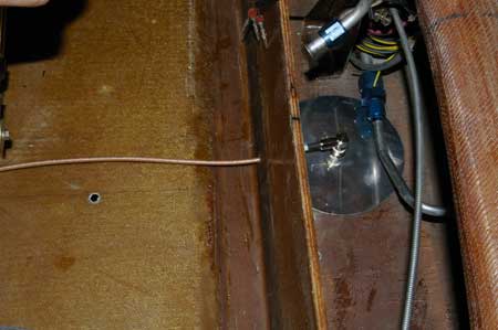

Hello All,
My name is Andy. This post is regarding ADS-B Out and its affect on avionics. My interest is to share information that may be of interest to aircraft owners. Apologies for the length.
I built and fly a Velocity. Last fall I took the plunge and upgraded to become ADS-B Out compliant. I have a 430W and bought a freshly upgraded 330ES. The installation went well. After a software upgrade for the 430W, the system certified on the ground and, on the first flight had zero errors and qualified for my ADS-B rebate.
Upon installation of the 330ES, there was a moderately loud and persistent ticking in my headset. It was not there when I had the GTX-327 in the panel. To be clear, this isn’t a little ticking in the background. It is of moderate volume and constant. It is not affected by the volume controls.
ADS-B Out transmits a complex packet once a second, every second. Mode C & S transmit only when swept by the interrogation signal.
I asked Larry, the avionics tech at May Day Avionics, if he knew what it was. He did. He claimed it was RF coupling between the transponder signal and the other avionics. He had worked with other owners on the issue. He was never able to eliminate it. By moving the transponder antenna to a new location, further from the pilot, he was able to attenuate it; making it livable. Still, it was a fishing expedition.
I asked for help from the Velocity community. Several engineers stepped up and suggested tests to isolate the problem. After several rounds of testing, we had narrowed it specifically to the transmission from the transponder antenna interacting with the Bose A20 headset and the Garmin GMA-340 audio panel.
With the Bose A20 unplugged from the intercom, I turn the ANR on and I will hear the constant ticking. I can walk all the way around the aircraft and there is ticking. It can be perceived from as far away as 20 feet from the transponder antenna.
By plugging a David Clark H10-13.4 passive headset into the intercom, the ticking can be heard. If the Bose was plugged in and ANR left off, the static can be heard. The 340 was also picking up the static.
A bit of research on the internet and I found a few examples of this static from others. It is more prevalent in composite airframes. Aluminum airframes are less susceptible, but not immune.
Garmin: I spoke with the Garmin Experimental support team. Steve is on this forum. He was very helpful.
They suggested a larger ground plane on the antenna. The theory on the ground plane “may not fix the whole problem but it does change the radiation pattern of the RF that is not sent out the antenna.” There was no guidance other than “larger” and it could be a fishing expedition. I tried one 4X larger with no perceptible change.
They suggested I try the new GMA-245 audio panel. I wanted to know if they *knew* this would fix the problem. It will be an expensive test if it doesn’t work. Steve replied “The GMA 245 is a brand new 2016 digital design that incorporates some technology that might make it outperform the GMA 340 in this installation. When we were developing the GMA 245 we specifically tested it in my aircraft to make sure it could reject the transponder and COM radio RF signals in a composite aircraft.” He said he still can hear some static in his Long-EZ, but “It is pretty subtle and I tune it out in flight.”
Tim Hass at Approach Fast Stack sent me a 245 to test. It worked. The static being picked up by the 340 was not there in the 245. Thank you, Steve. Thank you, Garmin. Goodbye $550.

The nice thing with composite airplanes is that adding ground plane size can be done as simply as applying aluminum foil tape. While not ideal, this method is actually quite effective at improving protection of elements inside the airplane from high intensity radiated fields coming from such things as transponders.

A Dummy Load was tried. It did confirm it is radiated RF. I am using RG 400. I did try another cable. Actually, I tried a certified transponder cable from a Cirrus.
No change in the static.

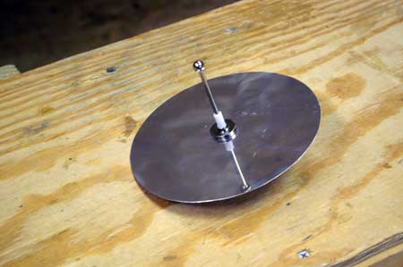

I'm curious about what type of antenna you are using, and if you experienced "clicks" with your previous transponder that corresponded with secondary radar interrogations?
I have a monopole with a 1/4 wave ground plane. It was tried with a much larger ground plane. The antenna is mounted between the main landing gear and protrudes from the bottom of the fuselage.
However, I also tested with a dipole.
It didn't make a noticeable change.

I noticed in reading the details on some manufacturers UAT transmitters that some create 40 watts of RF and some 20 in the experimental versions. Have you looked up the power out. The idea to do a good SWR measurement is accurate. Many of us are using transponder antennas and getting OK results, but the UAT is really at a lower frequency of 978. An antenna cut exactly for that is what is appropriate. My Bose picked up the missile radar over Salt Lake City winter Olympics. But I was locked by two F-16's. Another story for another day. The ANR is converting RF at a diode most likely... as mentioned. You certainly have been thorough in your testing. Thanks for sharing all the details.
For reference purposes, the VSWR?s of two typical antennas used for ADS-B / UAT.
The first plot is a stubby monopole transponder antenna.
2.623 @ 976.74 MHz
1.762 @ 1029.17 MHz
1.195 @ 1087.21 MHz
The second plot is a standard blade type transponder antenna.
1.364 @ 976.74 MHz
1.191 @ 1029.17 MHz
1.137 @ 1087.21 MHz
Data recorded with Anritsu lab grade equipment, calibrated with traceable standards.
8" dia ground plane.

I followed the FreeFlight advice of a 5.25" square ground plane to avoid resonance issues. They advise that a circular ground plane is one of the worst geometric shapes for ADS-B out. They also say as the square increases in size from the 5.25" square there is an attenuation loss until reaching a much larger size (something over 20"). Don't ask me the reason why .... I am but a dirt farmer and won't second-guess the engineers.
Here is a square ground plane I made for a fabric airplane:
Remarkably, in the FreeFlight literature it shows both a max and a minimum length of coaxial cable depending on the type. For RG400 the minimum was very high like 15' and my antenna was only 5 feet away from the ADS-B box. So I went with the higher-loss RG316 double shielded coax since it's minimum was only 6 feet. So in the case of that manufacturer their equipment has to have some loss in the antenna system or interference happens. I found it incredulous to substitue my quality RG400 with the small diameter cheesy stuff like comes with handheld GPSs. But a quick email to FreeFlight confirmed their minimum coax lengths based on loss. I could have even used that black single-shielded RG174 to satisfy the loss requirement designed into the system.
And all this time I thought I was being a good boy by limiting the antenna lead lengths and using only the highest quality coax. That rule of thumb went out the window in the case of my ADS-B installs.
So you might re-try a square ground plane with some lower quality coax. Or at a minimum run the question by Garmin of the need for attenuation in the antenna connections and lead run length minimums.
