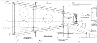

I had hoped to have received my borescope, but it was delayed. Still, I was able to get some updated pictures which I have annotated. I originally thought maybe the longerons were cut a little short, but comparing them to the plans they look ok. Instead it appears the builder added a couple of filler pieces between VS-803PP (Vertical Stab rear spar) and the fuselage skin. To me this looks better than what I was originally thinking from a structural integrity perspective.
After removing the funky elevator stop, I found the elevator travel is still the same. I found no binding up front and verified the point DanH showed in his attached illustration. The travel limit is very spongy at both extremes with no hard limit, but travel remains about the same as originally measured.
The ailerons on the other hand have full travel and the limits on those are the stick boots. This explains the spongy feel at the limits for those. That said, there are no installed stops and with the stick boots removed, the travel is limited by the floor ribs.
Excerpt from plan page 34 which I am referencing along with pages 28 and 6PP:
