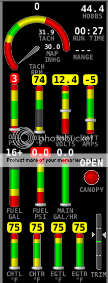

I was wondering how to add Tach Time to be displayed on Skyview EMS screen. I can find where Tach Time is recorded but I was trying to find out how to display it below Hobbs Time on the EMS.
Looking at the Installation manual (I'm not near the hangar) I'm thinking:-
SETUP MENU > EMS SETUP > SCREEN LAYOUT EDITOR> 100% and select sensor then ACCEPT.
not sure if the Tach Time is an option on the sensor list here? If it is then I presume you can toggle it to where you want and maybe select the size?
Thanks for any pointers!
The way you described should allow you to do it, but the reason tach time is not pre-configured is Rotax specifies that all maint. be done relative to Hobbs time.
Since people don't usually want to use tach. time for there flight time log, that makes having it always displayed, just wasting prime display space.

I actually made mine small and tucked it inside the tach arc. Out of the way but still useable. Still, don't use it much ...
