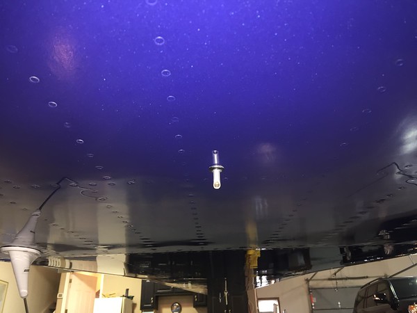

I made each wing tip a 9.5 gal tank. The result is 60 gals of fuel in an RV-7A, making 6.5 Hr legs possible...

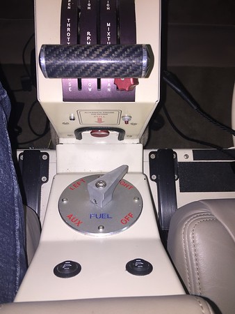

Special ordered a 3 position fuel valve from Andair, no John Denver style valves here. Aluminum hardline to the fuel valve.

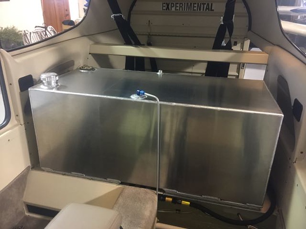

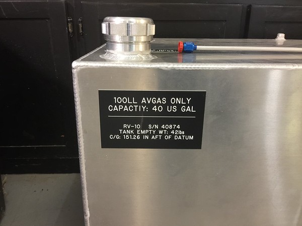

RV10 Aux Tank
Paddy tell us about your tank. Did you make it yourself? If so some details, materials, constructions, plumbing. Thank you.

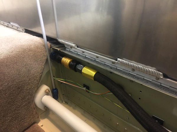

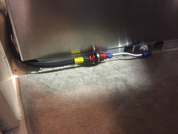

I designed the tank and sent it to a welder to fabricate. It's made of 1/8" 5052 and has 2 internal baffles, a float sender unit and a small sump for the gravity feed. The plumbing consists of a finger strainer in the sump, an in-line filter and AN-6 supply hose. The hose has a JiffyTite quick disconnect to a fitting on the side of the tunnel just ahead of the rear seat bulkhead. Inside the tunnel, there's a hard line to the 3rd port on the Vans brass fuel valve.
The tank is secured in the front with extruded hinge riveted to the forward edge of the seat pan. The rear uses the existing hinge for the rear seatbacks as well as AN-4 bolts to the rear seatbelt anchors. The breather is a hard line that connects via AN fittings at the top of the tank and on the side of the tunnel. There's an elbow from the side of the tunnel to the inboard side and down through the floor to the vent stub on the belly.
The tank can be removed or installed solo in about half an hour. When I made my transatlantic trip, I brought the rear seats with me in the baggage compartment and installed them in Ireland so I could take my family up.
