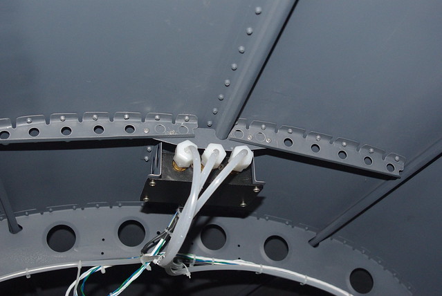

When I first started my airplane's engine, and did initial ground runs, up until the present, I have had periodic verbal Caution messages, with an annunciation CAUTION: ACTV ADAHRS VIBRATION.
I posted on the Dynon Forum, and receiving no response, I called Dynon, to find out what it meant - especially the ACTV part - since that's not called out in the Installation Manual. Initially, they couldn't tell me - but later we figured it out as meaning ACTIVE - related to systems where there are two ADAHRS installed. and they recommended replacing the ADAHRS. I elected not to do so until I could track down the source of the vibration. I figured it was pointless to go through the contortions needed to crawl back into "that hole" - made even narrower now with the fuel tank installed, if I could even do it, that is, without pulling the tank - only to find that the reading was accurate and not related to the ADAHRS.
During my Phase 1 flight testing, the Caution came and went. I tried turning that Dynon Lady off, but couldn't, and have grown accustomed to her talking to me throughout most flights. She even started saying "G's", which took me a month to figure out. The vibration would sometimes trip the G-Meter, which I reset to 3.0
To gauge my vibration, I made flights with Tony T. in N577RV. I also had made multiple flights in the Vans demonstrator. My vibration - meaning mostly engine vibration - seemed more than his, but not out of line. He had done a prop dynamic balance. In any event, I went through a long process of trying to check and eliminate any vibration, including checking the engine mounts, the prop spinner run out, and doing multiple blade pitch resets. I even had Jim Scott of Aircore Aviation at Arlington do a vibration check and prop reset, including a careful setting of the blades to ensure there was no difference between them in pitch. I am also setting up a prop dynamic balance - which I figured was my last chance.
I downloaded all my data after each flight and analyzed the vertical and horizontal acceleration. Horizontal seemed OK, but there was definitely a lot of Vertical G. I did several RPM vs Vibration surveys, running from about 3500 rpm to 5200 rpm in 200 rpm increments and plotted the results to find some correlation between the two. The correlation, if any, seemed tenuous at best - the engine does seem to vibrate more around 4800 rpm (considered typical for 912s by many.) I also did similar airspeed checks and did a big Internet search. I thought I could trigger it sometimes doing stalls.
The vibration started to affect the PFD - with the horizon line and slip/skid ball jittering - sometimes very badly. Dynon sent me a new ADAHRS.
To make a long story short, I am now on my third ADAHRS box. Changing them is NO FUN. The third one I installed with thick rubber spacers between the ADAHRS feet and the Vans ADAHRS brackets - still no joy. I still have the vibration. I've had sit down meetings with Dynon about this.
A few days ago, as I was standing alongside my airplane, I pushed the area where the ADAHRS mounting brackets are located - I was amazed. The crown skin in that area was VERY flexible - almost like a trampoline. If you put your thumb on one row of support bracket rivets, and your other fingers on the other rivet line and rock back and forth, you will find - or at least - I found - there was tremendous flexibility.
I thought I had found my problem.
Doing the same at the F-1208 frame shows it to be very rigid -as to be expected. The crown skins between the frames are VERY flexible. Using the template, I re-confirmed the brackets were correctly located.
On Thursday, I flew my airplane into the Arlington Airshow. At Van's request, I parked my airplane on their show line next to their RV-7A and RV-14A demo airplanes - between the Vans and Dynon display tents. Steve has been my Dynon Tech Support contact - he was manning their tent. I showed him my findings - he was amazed and felt sure that was the source of my problem. Joe Blank was manning the Vans tent - same reaction. The second Vans guy (whose name eludes me) said they had been having the same problem on at least one factory built S-LSA airplane during flight testing.
Everyone felt this area would be subjecting the ADAHRS to a high level of vibration susceptibility - either due to engine/airframe induced vibrations, or simply due to aerodynamic forces at different airspeeds and attitudes, as the airstream (perhaps) burbled off the aft canopy/crown area (especially during high nose attitude maneuvers.)
Everyone agreed I needed to beef up the area, by stiffening the crown skin in the transverse direction (athwartship is the Boeing term). Various schemes were discussed - from using a part of a new F-1208 frame, fabricating from scratch stiffeners, and gluing or riveting them to the crown skin, to bonding lead/rubber pads (as I have used on boats) to the inside skin. Even attaching an external transverse doubler. I've also thought of duct-taping some sort of doubler to the outside and see if that eliminates the vibration problem.
I recall an assortment of other postings here that described verbal "G's" messages, and jittering horizons and slip/skid balls. All may be related and a result of this installation configuration.
I plan to call Vans first thing Monday morning and get their views and advice, before I engineer my own solution, and will keep the crew here advised.

This photo might help. You must ignore the reflection however. The strength in the center is nice, but you can see how it would "rock" on the mounting.

It's on the top centerline between the Aft Cargo Bulkhead and the F-1208 frame.

Thought I'd see if I could stiffen up the fuselage around the ADAHRS mounting and after a bit of head scratching came up with this:
I didn't want to attach anything directly to the ADAHRS bracket because it's too difficult to work in that confined space, and I also didn't want to have to touch those pesky little bolts again to remove the unit.
Seems to work pretty well. The whole area is very much stiffer now, and I think the ADAHRS should be solid enough. All parts are made from 0.025" because that's what I had available, but thinner material could be used for the two ribs. I wouldn't go any thinner for the centre joining plate. The plate is important, because the ribs need to be connected together with two rivets each side to work properly. I made a second set of ribs to go behind the ADAHRS unit, but didn't install them because the first set seemed to do the job. I don't have my turtle deck riveted in yet, so I was able to install the new parts without climbing into the back.
The ribs are 5/8" deep at each end, top flange is 1/2" wide, bottom flange 3/8". Rivet spacing is 1-3/16" with the first rivet 1" from top line of fuselage rivets. Centre plate is 1/2" deep under the J stiffener, and is about 6" long. Drill the two rivet holes for the plate in each of the ribs before installation, and then match drill the plate later. I had already put the ribs in before drilling the holes, which resulted in me not getting the rivets quite where I wanted them because it was a bit awkward to reach in and position the drill accurately, but they will have to do now.

I attempted to fab a stiffener bracket similar to the one RGMWA made, except mine was one piece. After installation I was not real happy with the result.
3
Although it did reduce the flexing a bit, I decided to try a doubler plate to fix the problem.
3
The doubler is a single piece of .032 that is tapered to match the decreasing width between the J stiffeners. The curve was made by fluting the 90 deg flanges to match the skin curve perfectly. The J stiffener has a 1/2" wide .032 doubler between the skin and stiffener to match the bracket thickness. The ADAHRS bracket was riveted thru the skin and doubler.
3
This is a comparison of the two bracket approaches I tried. Although is weighs 2 oz more, the plate doubler design has eliminated any flexing in the ADAHRS mounting area. Now that I have finished, I am sure Van's will release their version any day.

John, the position of the rib is important. Mine is located just 7/8" in front of the most forward rivet holding the ADAHRS bracket, and is actually aft of the pressure fittings. It works well in that location and provides more than adequate stiffness. However there's always more than one way to skin a cat. :)
I also considered a two piece design that incorporated the ADAHRS brackets as part of the sturcture. The one I ended up using is similar to the doublers I added for the COM2, GPS, and ADS-B antennas. You can see the COM2 antenna doubler in the photos aft of the ADAHRS bracket (along with two additional J channels to fix a similar flexing problem).
