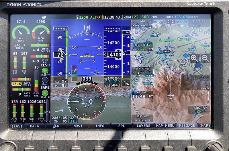

My RV-12 was first flown in 2015. It has a 912ULS. This flight was yesterday 10/20/2020. It is not my normal cruise, I only went up this high to see what she could do.
I did not reset the barometric altimeter from where I took off, you will see the GPS altitude (14749') is different from the barometric (14100'), The GPS is probably the accurate one. Also note the density altitude (16043'), that's where the airplane was actually thinking it was at.

Did you fly over San Jacincto mtn? That's impressive... was the throttle to the wall and only making 4990 rpm?

It averaged 5000 RPM @ WOT.
Most normally aspirated engines don't make full power at high altitude.
High altitude = less oxygen = less fuel = less power.

True, but I have never seen the RPM run that low on an RV-12 at even 14,000 ft.
You must have a prop pitch that is rather course compared to most.

It was actually 16000 but maybe there is still a prop pitch issue. I will get some screen shots today in different situations maybe that will help sort it out.
Scott,
What do you think of these numbers? I just flew this today, weather and temp very close to the same flight above.
Run up on ground at 1570’, WOT 5040rpm
Climbing through 3400’, 77kts, WOT, 5130rpm
Level at 7500’, 110kts, WOT, 5700rpm

Barometric pressure at airport on take off? 2995?
Air Temp? 23-25C
If that is a question I missed the intent.
I've noticed barometric pressure and temps have an effect on the rpm's I get on takeoff and 75 kt climb out rate. 5150 to 5220 rpms at 75 kts. I also seem to gain rpm on hot days with higher barometric pressure.... 34C and 30.17 at 75 kts 5210 rpm. YMMV
I suspect there are many variables. One being oil temp, probably an optimum temp where friction is lowest. That can vary day to day depending how much time you spend on the ground before takeoff.
