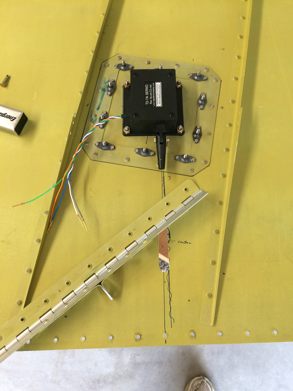

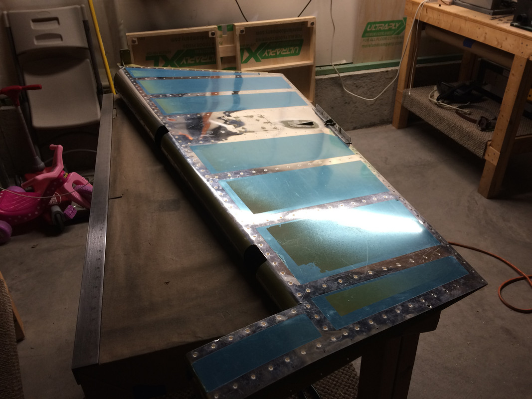

In regards to electric yaw trim I fabricated a ray allen servo in the rudder with a piece of piano hinge on the trailing edge. Is it needed in a 14? No. But I wanted it so I built it. It is controlled by a ray allen rocker switch on the center tunnel.
Sorry, not the best pictures of the electric rudder trim, but you get the idea.

In case you haven't seen this report:
https://smartpilot.ca/images/TSB/PDF/a10o0018.pdf
The addition of weight, however, can decrease flutter speed by 50 knots or greater.
Any imbalance, such as paint and filler, which increases the weight of the rudder aft of the hinge line, has an adverse effect on flutter speed.
So after reading the report my takeaway is that the builder should be sure to balance the rudder/ailerons with the appropriate counterweights after painting or otherwise adding weight to the aerodynamic surface. A good procedure to do no matter what is installed. If done properly there is no effect on the "flutter speed". Sounds like everything on the plane whereas if it is done improperly it may kill you.
Maybe.....
One of the influencers of flutter susceptibility is control surface stiffness.
Not saying that yours is at risk (can't tell that from just looking at photos), just pointing out that balance is not the only thing to consider.
The challenging aspect of doing a mod. like this "properly", is how much balance weight to add.
If I remember correctly, the RV-14 rudder if built to plans is not 100% statically balanced (wasn't needed for adequate flutter margin). That means that at a minimum the balance should be adjusted to get it back to the same point it would have been without the rudder trim system. Going a little further would probably be wise to account for a potential slight degradation in overall stiffness.
The reason for doing this vs just balancing 100% is that I think you will find that to do so would require adding a lot of additional weight which considering the location, can induce other problems.
