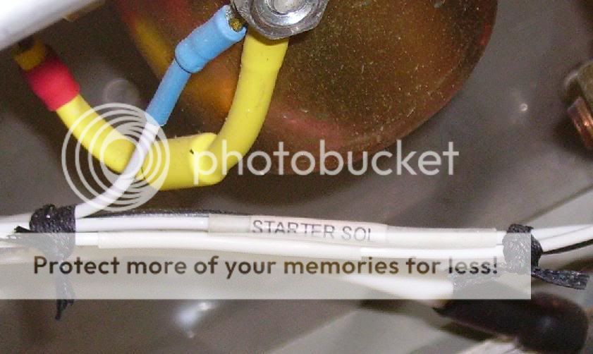

Maybe I'm not the first guy to think of this, but I just found an excellent, cheap way to label all my wires. For a very long time, as the wiring project drew near, I wondered about how to label my wires. I do think it's nice to have a label on every wire. I figure I might be the guy on my back under the panel some day, and I'll be glad I had taken the time to do this. I thought of buying one of those expensive heat-shrink printers. I've read lots of stories. Heard a lot of frustrating tales. I didn't know what I was going to do. I was actually at a point where I thought I'd bag the idea and just have it all down on paper, rather than spend that much. Then I stumbled across this material and came up with a simple idea.
A local electronics supply store carries clear heat-shrink in all kinds of sizes. I'm sure you can find this anywhere. As you can see, it's CHEAP. Little more than a dollar gets you 3 feet of it. I bought several sizes, and I may go back for more if I need it. Then all you need is a roll of white electrical tape and a super fine sharpie.
The rest is obvious. Print small. Cut the tape and wrap it around the wire. Apply heat to a short piece of the clear heat shrink. Try this, it works! Even on the smallest wire sizes. And did I mention... it's cheap!
I know, it's not as elegant as something that came out of a fancy heat shrink printer, but who's ever going to see it?

Alternatively, you can write on the heatshrink itself, they stay on and shrink proportionally.
I did a similar thing except I just used white heat shrink tubing. I wrote what I wanted on the short piece of tubing with my sharpie and then shrunk it on the wire. The lettering shrinks along with the tube as is easy to read. Stein sells it and I also got some at Lowes. The stuff at Lowes came in a small pack of about a dozen 3 or 4 inch pieces, 1/4" and 3/16" diameters. I cut these in half and that was just right for marking.

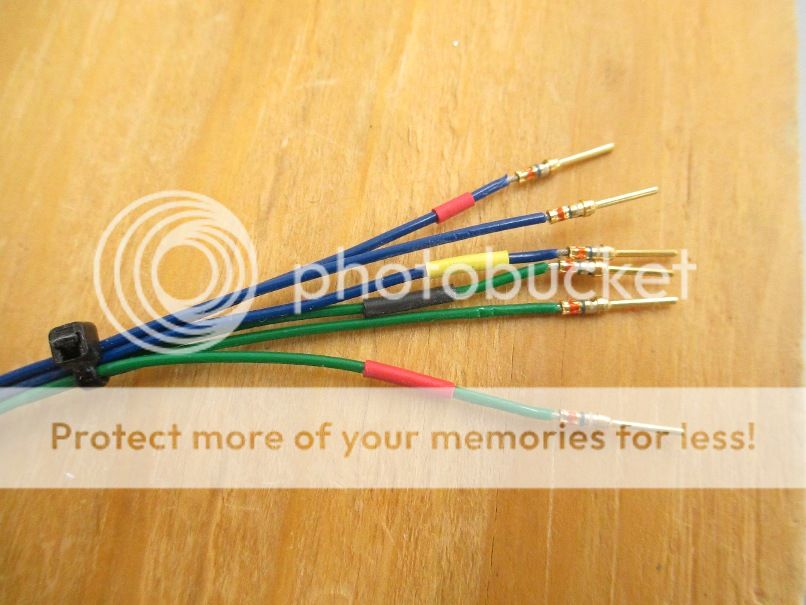

Just like this - from an old VAF posting -
However, sometimes you don't really needs labels, just wire identifiers at each end. Using short lengths of colored heat shrink on the wire can act as a low cost, easy identifier.
Kitplanes published this idea last month...:)
More combinations can be created by using a second shorter piece of a different color over the top of an existing color.
