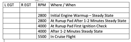

If you’re inclined and follow post #30 above, also record L and R EGT’s. Do this during initial warmup at 2800 RPM, again after you taxi to runup pad, and also in cruise flight.
Something like this….
