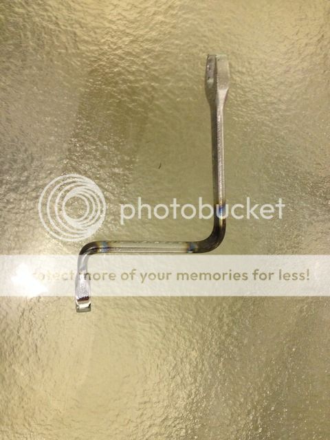

I do it with a wrench I made like this:
and a second person on the torque wrench underneath, not ideal torquing the bolt but it is what it is :eek:
