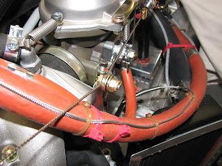

When installing the hardware to attach the throttle cable to the throttle arm, the instructions ask for the Rotax locknut (silver in color, blue locking insert) to be re-used. This nut should hold the VA-219 bolt which has a hole for the throttle cable to pass through.
When I was trying to tighten this assembly, I noticed that the nut went on the bolt without hesitation - even when the locking feature was passed. Also, it appeared to be odd that the Rotax lock nut is a metric size while the head of the VA-219 needed an imperial size wrench.
My lock nut tightened a bit until it sheared off some threading and then would not go anywhere except off.
Closer examination showed that the VA-219 threading is indeed imperial size and the lock nut was definitely not.
I decided that an AN365-1032 locknut should be a perfect fit, given the dimensions of the VA-219.
I searched the forum but could not find anybody else having this problem. Am I missing something? My 50-05 is revision 1 from 10/12/09 and has not been revised since.

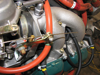

I'll be interested in the answer to your question. While adjusting my throttle cable, I ran into trouble having the throttle arm not rotating freely about the bolt. Investigation revealed I had buggered the small shouldered bushing - it became deformed/ovalized when the nut was torqued. The nut gets quite a high torque - 35 in-lbs (MM pg 12-10) - it seemed very excessive when we applied it with a torque wrench - and then we had this bushing problem. (It was OK before we messed with it.)
I ordered new parts for both sides from Lockwood. While doing so, I noted in their Parts Catalog that they called out a Rotax bolt (screw) - P/N 241-847, which is indeed metric (and $15.59!). So, I ordered the bushing (called a graduated sleeve - which costs $15.20!), washer and nut from Lockwood, and the Bolt/screw VA-219 from Vans (which costs about $13.)

I've encountered this in sailplane and bicycle hardware. What I found is that there is a metric standard that is virtually indistinguishable from 10-32. Looking at RC forums, it looks like it's M5x0.8:
#10 nominal dia = 0.190" (yes, it's not 3/16" or 0.1875")
M5 nominal dia = 5mm = 0.197"
0.8 pitch = 0.8mm/thread = 0.0314"/thread or 31.75 tpi
32 tpi = 1/32"/thread = 0.03125"/thread or 32 tpi (tautology alert!)
So you can see that for looser holes and lower-tolerance hardware, it would be possible to interchange 10-32 and M5x0.8 screws to some degree. A 10-32 screw in an M5x0.8 nut will be a little loose, and an M5x0.8 screw in a 10-32 nut will be a little tight, but both combinations could probably be threaded together by someone who wasn't paying attention. I know I've done it myself.
Of course, one important issue here is that the tensile strength of the joint is an unknown. I imagine that the slight mismatches would result in sub-optimal joint geometry, and a commensurate reduction in maximum strength. I would also bet that a #10 screw in an M5 nut would have less than satisfactory engagement with friction locking features.

I can't explain why you haven't gotten a response from tech. support (if one had been promised), but I can tell you that the issue has been looked at by engineering.
The issue arose when an early production vendor change was made, switching to a different throttle control (McFarland). The cable diam. was larger and wouldn't work with the Rotax supplied bolt.
A mistake was made in specifying a new bolt but not also changing the nut.
The reason it hasn't been an issue after many RV-12 completions, is because our research has found that the actual dimensional differences and thread pitch difference between the supplied AN bolt and the original metric bolt are very small (thousandths of an inch). It is likely that the small number of builders that have noticed some interference, was because of manufacturing tolerances of each piece of hardware.
A change is being worked on, that will specify that an all metal lock nut, appropriate for the AN3 bolt, be used instead of the OEM one.
I think this whole stackup needs to be careffully reviewed by engineering. This is a critical piece of system.
As it stands now, we've got a Vans screw and three pieces of Rotax hardware. If a new locknut is specified, we'll have two english pieces specified by Vans - the screw and the nut - and two metric pieces specified by Rotax - the washer and the shouldered bushing (which sits in the Rotax throttle arm.)
What's a washer, you say? In my case, I think I buggered the expensive shouldered bushing because the washer was the wrong size. The washer is important!
