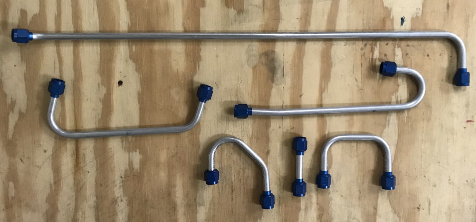

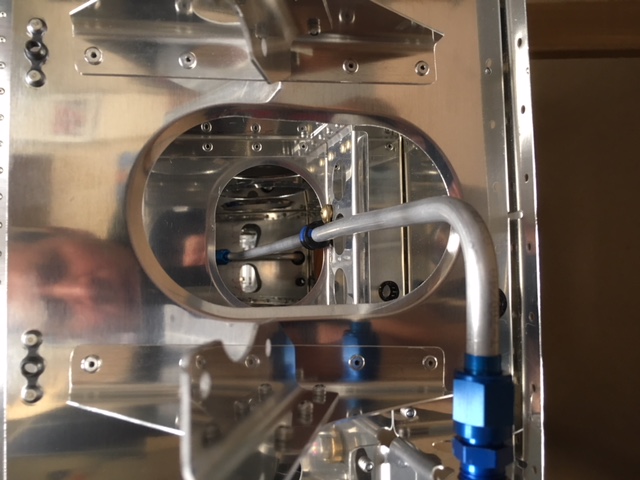

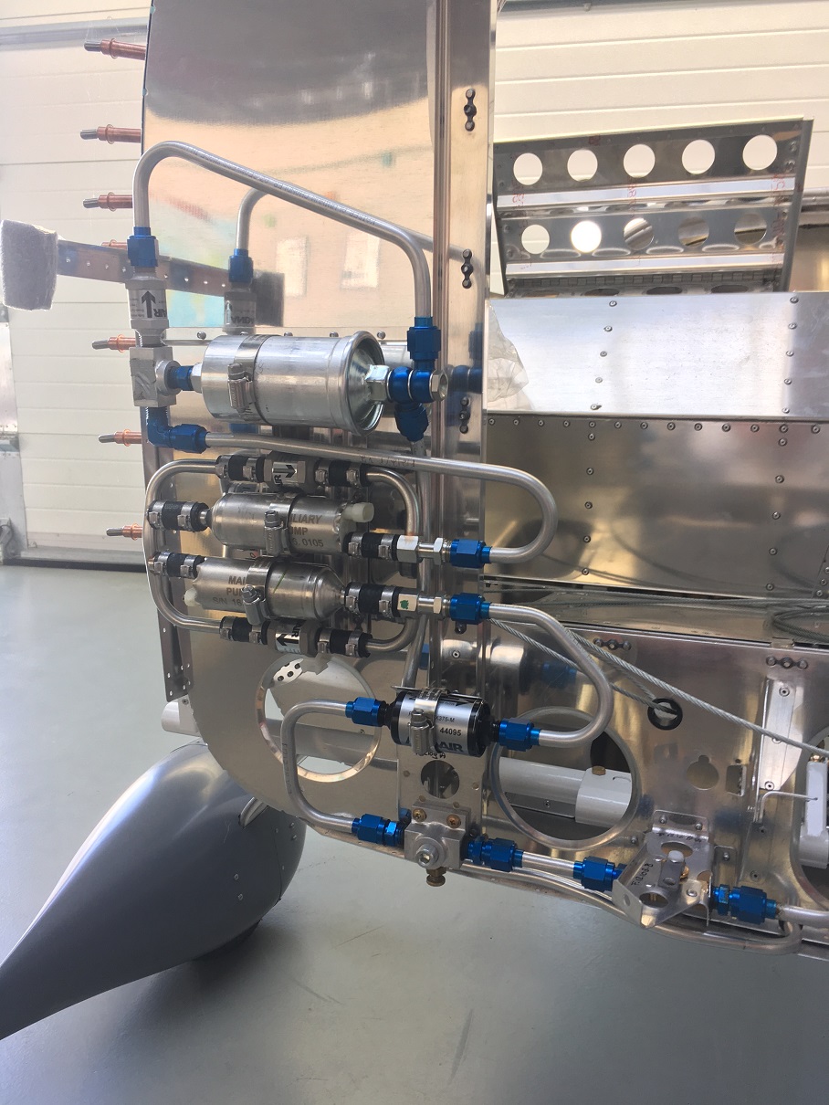

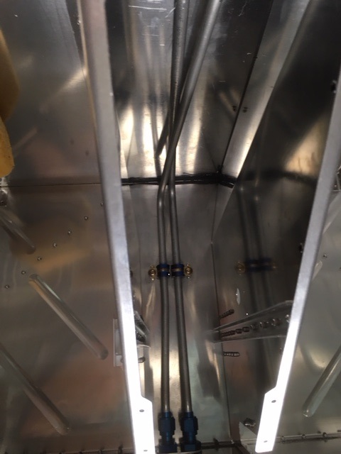

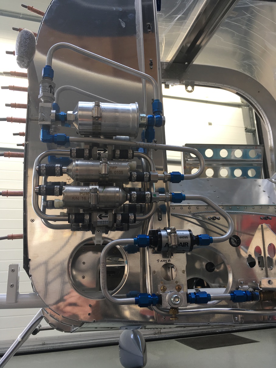

Van's has finally begun shipping Engine kits and we have now been able to do fit verification tests on our CNC bent Rigid Tube kit for the RV-12iS.
AS Flightlines has decided to offer the F12127E, F, G, H, J, and K lines. They will come pre bent and pre flared. The cost of the kit is $324.95, and we will be happy to buy back the unused AN Nuts and Sleeves from customers for $25 that won't be needed if you purchase this package.
In addition, we will offer the F12127B and F12127C lines for those customers that have not yet completed the bottom skin installation in Section 21. These tubes need to be slid through the bulkhead into place and then flared by the customer due to going through a grommet. The only way to offer these lines pre bent is to install them at this point in the build. These tubes will add $75 to the cost of the above package.
Below are some pictures of the pre bent tubes as well as what they look like once installed.
If you would like to see the design/fabrication process of these tubes, more information can be located at http://aircraftspecialty.com/howwemake.html under the "Rigid Tube" Section.
