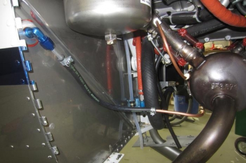

I think the stiffeners if I I'm thinking of the correct parts (mine came with them as part of the kit) can be seen in the first picture on here.
They are the two yellow primmer strips attached to the inside the forward side skin on both sides that I think are what the OP is talking about.

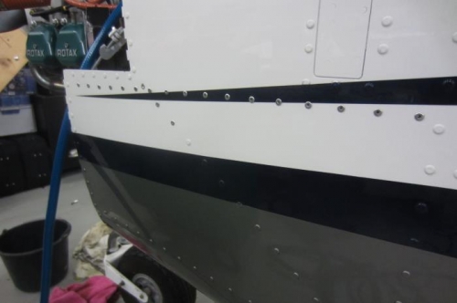

I am still trying to decide if I have them or not. Don't this photo indicate by the rivet pattern that I have them installed?
[/IMG]
Don, your photo shows the stiffeners are not installed, when the mod is done, there is another row of rivets a little below the line at the side skin and cowling intersection. There is also a diagonal brace on the passenger side firewall, running from upper right to lower middle. That one would present some grief with the engine installed, I would think.
