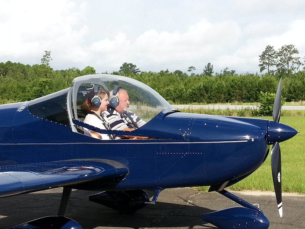

Will do... it will be an adventure, learning to fly in your own plane. People say a RV-12 is easy to fly... i'm hoping it's easy to learn how to land.
So much to learn.
2012, AP, also has steam gauges, airspeed and altimeter and backup dynon D1 attitude as well as back up Garmin Aera 500, wheel pants, 168 hours on Hobbs, Aux 6 gallon fuel tank and pump behind PIC. Will need to update to Dynon Skyview Touch, soon, it's in the budget.
Picture it in Navy Blue, and a silver pin stripe. Made me an offer I couldn't refuse, as all service bulletin updates with doublers and triplers, have been performed, not just "inspected" front landing gear parts coming my way, already on order, and trim motor bushing too.

Congratulations on your new plane! It's good to have another -12 in Southern California! Post photos when you get a chance.
Kind of felt a little lucky to not buy one in red, and white. Wish it was raw in finish and 25 #'s lighter, but buying used, you get what you get.
Looks good! Are you going to ride along on the ferry flight?
Unlikely, too difficult to find and coordinate.
I'd probably need a light weight female CFI to instruct to make under gross 1320# with a little bit of carry on. Finding one of those that wants to be cooped up with a stranger for 20 + hours of flight into headwind going west is looking for a needle in a haystack.
As it is now, I have a 165 # guy that's looking for an adventure, with friends along the way he wants to visit. He's in some sort of mystical "Quiet Birdmen" secret society, or something like that. You have to be voted in, so I am assuming he's done something right with all of his flying. Frankly, to me, it sounds sort of like some E Clampus Vitus group of airmen.
