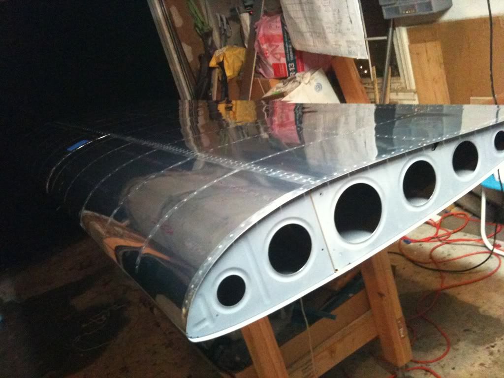

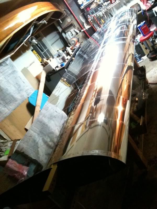

Av8torTom's Avatar
Join Date: Nov 2009
Location: Yardley, PA
Posts: 1,334
Default Flush set
I used a flush set, and I am very pleased with the results
You can see by the reflection how smooth the rivet lines are
