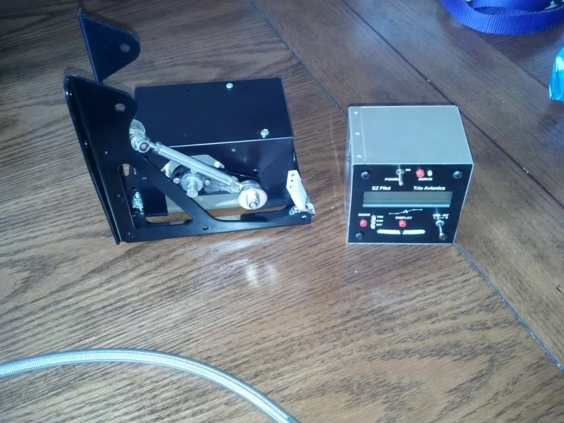

I bought a used Trio EzPilot autopilot from a fellow VAF (I think Gene used the money for Avgas with Rosie and the other Grand Turk travelers). I was replacing a Navaid A/P which never worked, turns out I wired it wrong
Anyway, I sent the EzPilot back to Trio to make certain all was well internally, get a new non-faded faceplate and get a new wing servo mount. Of course I picked Sun & Fun as the best time to send it in. But they hopped right on it and I got it less than a week later. Great service to get anything delivered to Montana in a week.

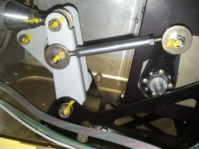

Installed. I thought working through the inspection port would be a pain, but really wasn't too bad. Took maybe an hour counting removal and finding a correct length bolt for the bellcrank pivot.
Still need to finish securing the wiring.

Don't forget cotter pin in the end of output shaft of the servo!!!

Not certain it applies to your model but look at the Trio web site for the latest service bulletin. You should put a washer on the servo shaft, and a cotter pin thru the hole in that shaft, to be sure that nothing can come totally apart even if the pin in the drive wheel comes out.

This isn't a Trio servo, so I think it doesn't apply....but won't hurt to pin it anyway. Thanks
